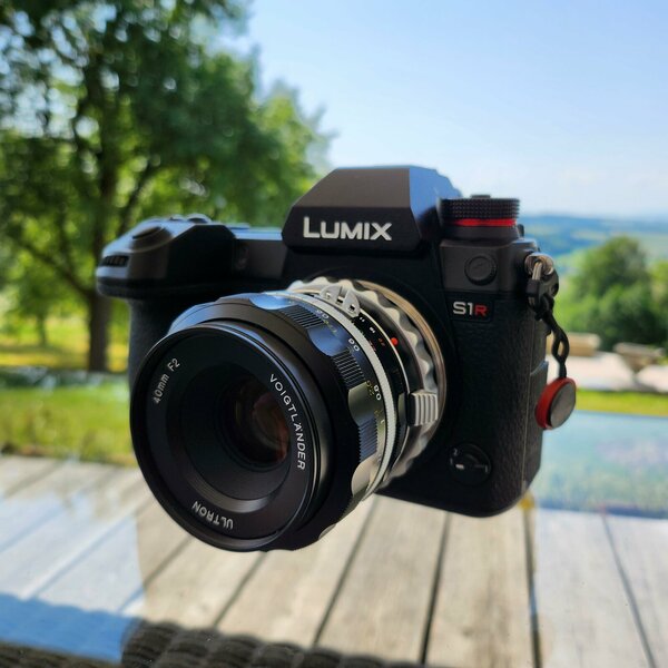

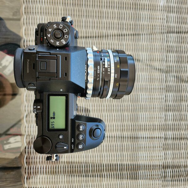

Yes, yes, I agree with both of you, I use a K&F Concept adapter for my Voigtländer 40mm f2 Ultron and the combo looks like thist on my S1R:
... not exactly a small combo... :confused:
this is the reason why, IMHO, it would be good if Panasonic or Sigma made a PANCAKE 40mm and 28mm for the L-Mount
I would buy the 40mm version for sure :)

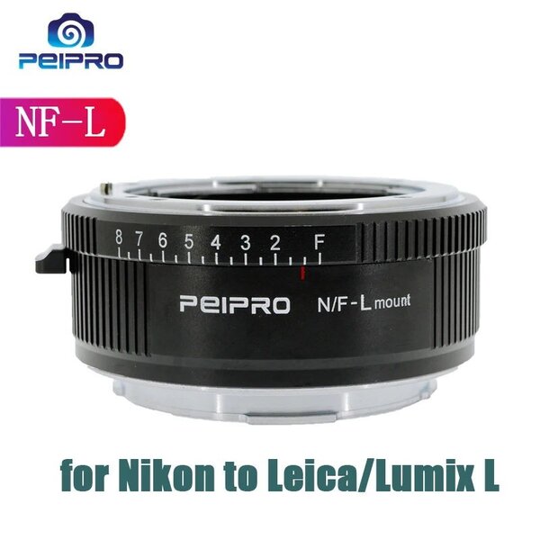

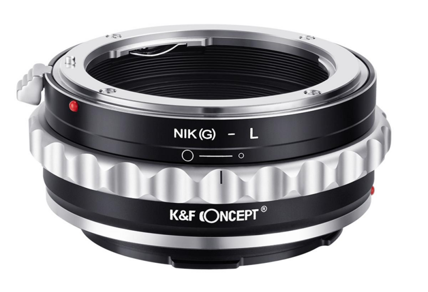

For the last option also the K&F model was part of this evaluation. Having this extra defined O---o ring
However I chose an "AliExpress" model over the K&F model, as the stepping part for setting aperture values by a separate ring
is more defined, by a more wide distance and clickable steps (by about ~1/2 steps) of the aperture ring than the model of K&F.
(However these "clicks" are a bit "wobbly" - not harsh, punchy clicks. But maybe a better choice against "no values" ring at all of K&F ).
AliExpress model - search for:
Peipro NF-L Mount Close Focus Adapter for Nikon F Lens Leica Lumix Sigma L Mount Camera 'S for S1/S1r Fp Sl/Sl2 T
I unscrewed the part of the tripod base, and covered the two remaining screw holes with a piece of matte black tape.
This adapter, by the extra mechanical moving ring parts, and unscrewed tripod base. The weight is more heavy: 141 gram
(Including tripod base even more heavy).
Peipro model:
Versus K&F model:

This post is to express my recent experience with both Lumix S1 and S1R II and the 40mm f1.4 Nocton Classic VM: I could not understand why some reviews had found acceptable results from S9 and S5 cameras while I had not had any satisfaction with the S1... With the purchase of the S1R II I've found much better results from this lens. It looks like Panasonic has improved the sensor stack with this newer camera. The results stopped down to f8 are very good and are what I had hoped for from this lens. Wide open there is a noticeable drop in performance as should be accepted but still very usable for good creative options. Babylonia's experience with the S1R and mine with the S1 confirms that these two cameras must have a similar sensor stack.
I wanted to post this so others using Lumix cameras may not be swayed from experimenting with these M and VM lenses and perhaps find a compromise that will satisfy. The bottom line is both S1 and S1R users should test before using M and VM lenses. I should add I have had good results with Leica M lenses longer that 65mm with the S1.
I hope to try a 28mm VM lens on the S1R II soon and will report my results.
...The results stopped down to f8 are very good and are what I had hoped for from this lens.

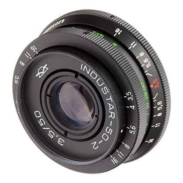

....Most lenses even from "ancient" photographic history as about 50-60 years ago do give "good results" when stopped down to f8
I do have a "Russian" (Ukraine) lens, named "Industar 50mm / f 3.5" - bought for about € 40,- including sending costs.
That can be satisfying many users when stopped down to f 8
(Even wide open at f3.5 it do have a very nice "natural" rendering when processed by today’s good RAW converters).
To mount on an "L-mount" camera. The adapter itself to match the camera is much more heavy than the lens itself ---> lens only is about 68 grams
The most tiny 50mm lens, but still have a remarkable quality. So what is your goal??
Looking to "fast" lenses. I am not interested which quality remains when stopping down to f 8
As "every" lens stopped down to f 8.0 are quite similar as for quality.
As a bonus, image from an "Industar 50mm / f 3.5"
Compared to what the S1 did with the 40mm on the S1 the S1RII is head and shoulders above better quality and not just because of the higher res of the sensor. Even stopped down it was not acceptable on the S1. For me I have Sigma L contemporary lenses when I want sharp well rendered pictures but many times a lens that is soft on the corners and vignettes when wide open is ok. These "bad characteristics can be used to advantage. Many of my ancient Leica lenses from the 60's and 60''s perform very well wide open. The sensor with a thick sensor stack will limit many of the wide angle VM and M wide and fast Leica lenses. I just wanted readers to know VM and M lenses are very sensor related. Not all Panasonic sensors can be boxed together as bad news.

I'm interested in your Industar. There are many LTM thread lenes I would like to explore. Please post a photo that expresses what you like about it.
