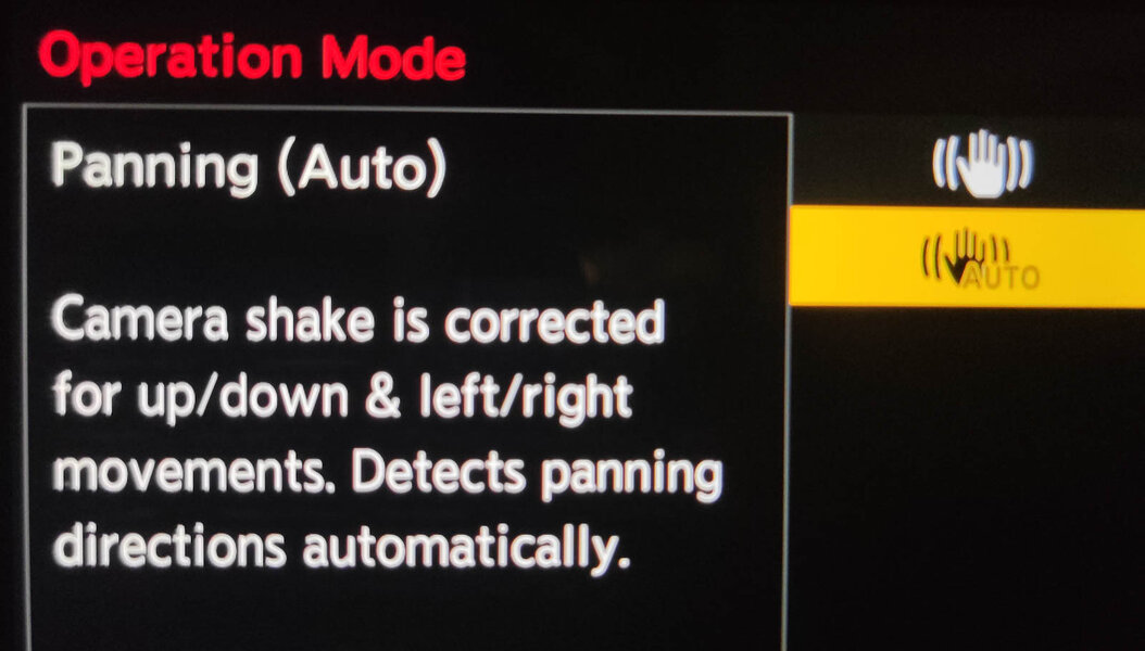

I don't know what to say. I've been running with the 20-60mm which is not a stabilized lens, so it is just the camera IBIS stabilizer. So I switched to the 24-105mm lens which is stabilized so the IBIS and lens stabilizer need to work together. The 24-105mm firmware is 1.3. I just did a 105mm pan shot of a car passing by, and don't see any sign of a stabilization problem. The settings are: Lens O.I.S. switch, ON. E-Stabilization, HIGH. Boost I.S., OFF. 4K30p, Photo Style Standard, shot at 1/125 sec, f/5.0, ISO 640, with a ND 0.9 filter.Nope, it's what I seen in the EVF taking the video.
