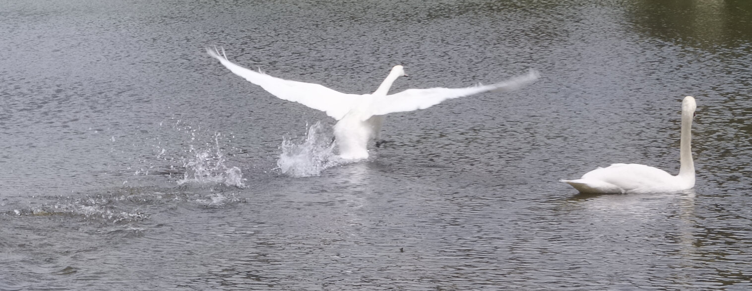

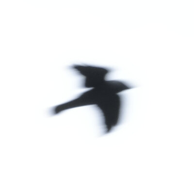

Here are two images that show problems caused by the fp L's rolling shutter. In both of them the shutter speed wasn't high enough to avoid motion blur, but there are also some distortions from the rolling shutter and the blurred areas appear to have been "smeared" in a way I wouldn't have expected from the motion alone. Both are actual size, cropped from the fp L's 9520x6328 resolution originals.
  • SIGMA - SIGMA fp L
  • 24mm F3.5 DG DN | Contemporary 021
  • 24.0 mm
  • ƒ/8
  • 1/200 sec
  • 24.0 mm
  • ƒ/8
  • 1/100 sec
