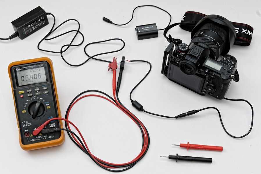

I think to get a proper answer here, a structured test approach is necessary. If I get the time, I'll try to do that. It would also be great if perhaps someone could find an easy way of measuring the standby current draw. I suspect a dummy battery with some wires coming out of it to a meter and then a realy battery would be needed, so not the easiest of things to arrange.

You mean like this:

Ha ha - perfect. So the S1 draws 5mA on standby? But perhaps the DC Coupler uses some too? The battery is rated 3100 mAh - so that's 620 hours on standby and it's dead (about a month).
It's more complicated than that. I wrote about this at length on DPR. The PSU outputs about 9.0V at low load. If most of the current is going through a buck regulator (I guess in
), the power will be nearly constant (rather than the current). So that 5.2mA might need to be scaled up by about 9.0V/7.5V = 1.2 when the S1 is running off a battery.
No.
It's just wires in a box.
See above (and DPR posts).
As I posted before on DPR:
  • Bluetooth & LCD make no measureable difference on S1.
  • The S1 measurements are quite noisy - seems like the main SoC wakes up every (ballpark, can't remember) 15 minutes, drawing ballpark 50mA. Hence the "average" mode on the DMM.
Anyone done this with an S5?
The S5 is more complicated.
On the 9.0V dummy battery supply:
  • 2.5mA for the first 6 hours (ballpark, time not measured).
  • 0.50mA thereafter.
Which is not great, but not so much of a problem as S1. My Nikon DSLRs are far better.
