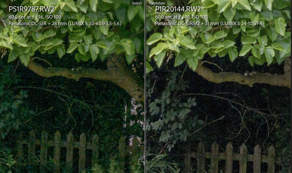

Firstly, here are side-by-side 100% views in LR of the S1R and S1Rii. S1R is on the left. Both images are pushed +2.25 EV and shadows +100 (yes, it's a torture test):
Neither is really accaptable, but the noise on the S1R is obviously much worse.

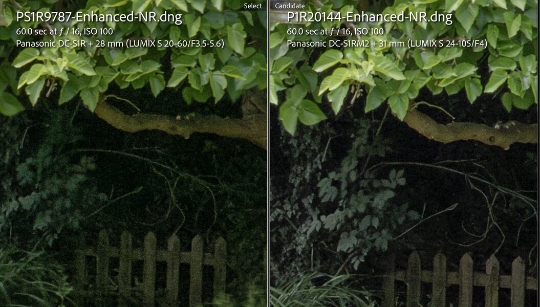

Now let's try turning on long exposure noise reduction at capture time (LENR, aka dark frame subtraction):
Things are a lot better for sure, but I still think the S1R image shows too much noise. The S1Rii is much cleaner.

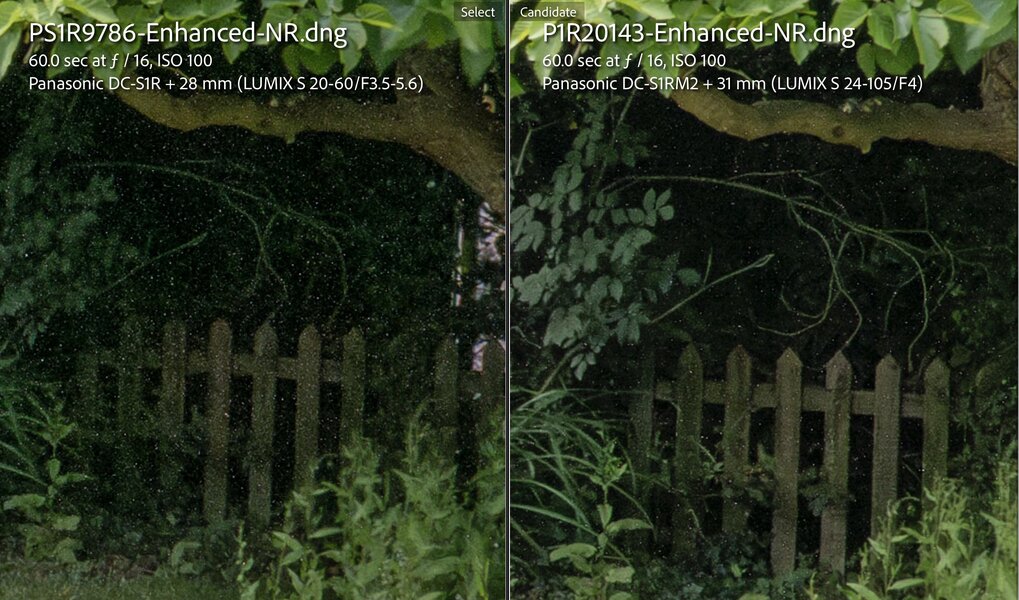

Now here are the above LENR shots again, but this time with them both having been de-noised with LR's "AI" denoise applied at 20%:
The S1Rii is clearly still the winner, but I can live with the S1R version now.

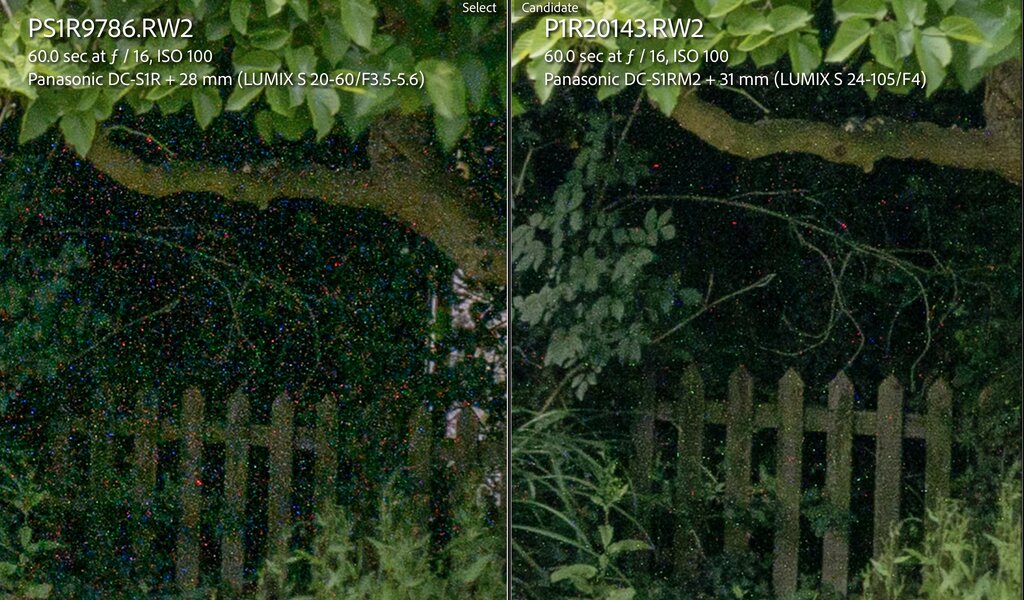

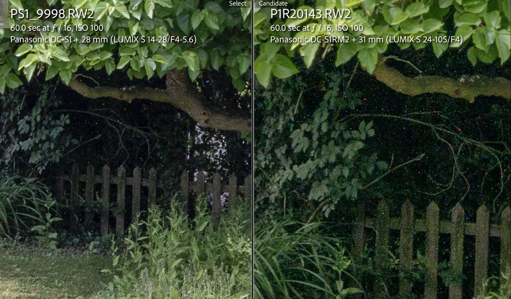

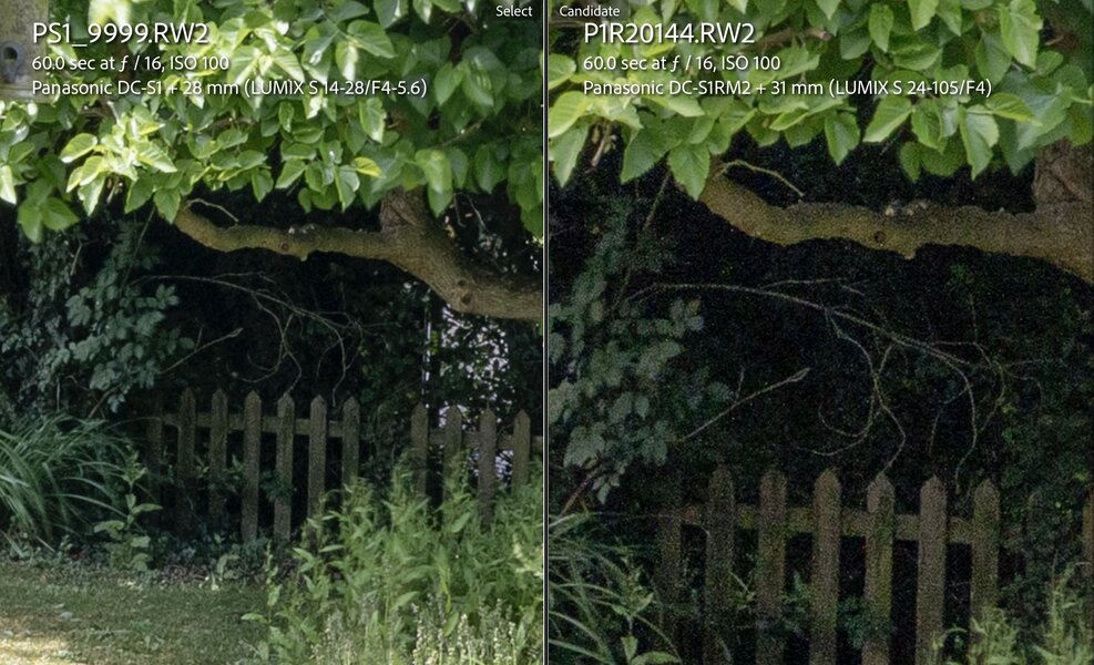

Now, here is the S1 vs the S1Rii - no NR, no LENR:
So, the S1 is pretty clean, probably slightly cleaner than the S1Rii, but obviously at a lower resolution. However, there is some colour speckling remaining in both.

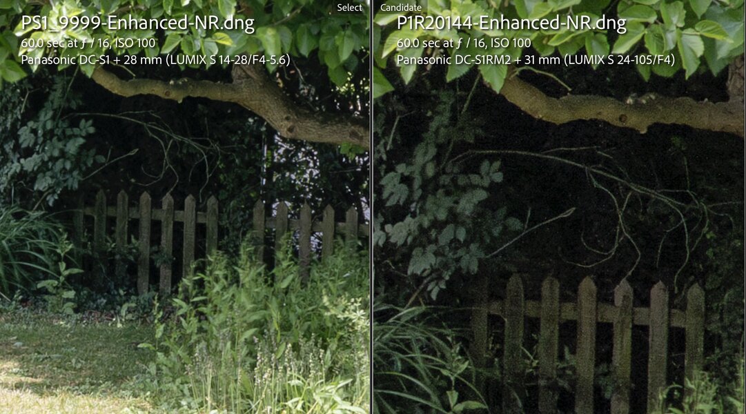

Here are the same two shots, but 20% denoise applied in LR:
Now they are both very clean - I'm more than happy with both!

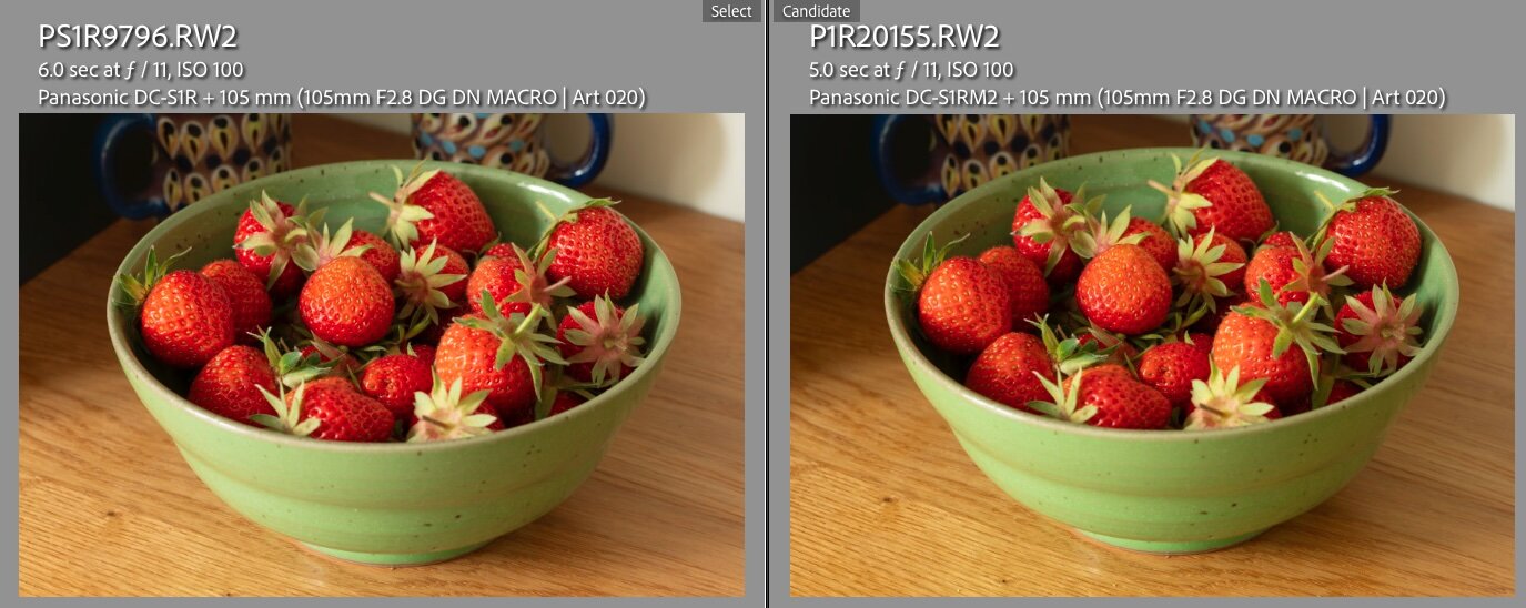

OK, so a quick real-life ISO test...
Here is the scene. Left with the S1R, right with the S1Rii.
Note the following:
- Both shot in raw and processed in LR
- LR defaults used for everything except WB, which was set to "daylight" for both
- The S1R exposure is 6s, S1Rii is 5s. In both cases I used the camera's suggested exposure in multi-metering mode
- I've pulled back the LR exposure slider by 0.5 stop on the S1Rii
So, a few points for this base ISO comparison:
- The S1Rii is definitely more sensitive (i.e. for a given ISO setting, shots from the S1Rii are brighter). Despite having a shorter exposure (5s vs 6s), I had to pull the exposure slider back by a little over 0.5 stop to get an equivalent brightness. The lighting was identical and the same lens was used. So, either the ISO calibration is different, or LR is processing the grey point differently. I need to shoot some in-camera JPEGs to determine which it is.
- The colours are slightly more vibrant with the old S1R. And in fact, in my subjective judgement, I think the more accurate rendition also goes to the S1R. This is something I love with this old girl - the colours are always so rich and accurate. Again, it could be LR's processing rather than something special with the sensor though - more investigation needed.

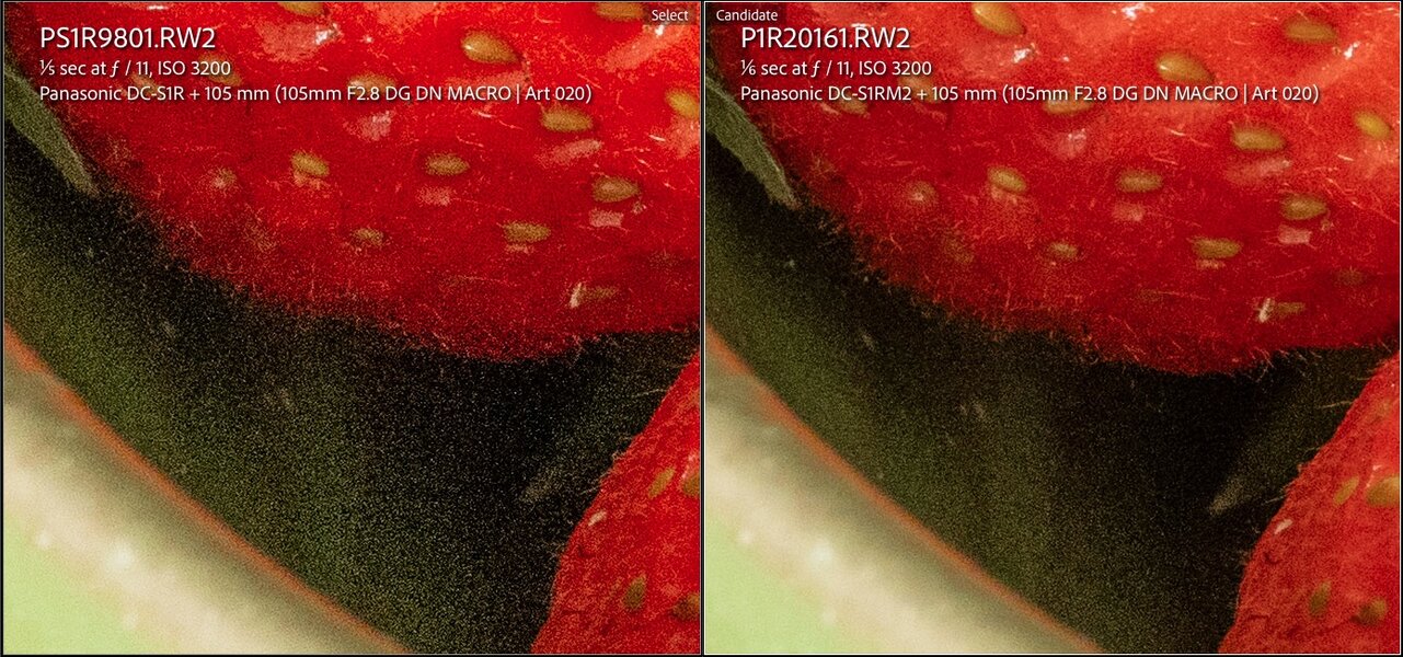

So, here is a comparison of ISO 3200 from both cameras where I've pushed shadows 100%:
It's quite clear that the S1R has more noise in the shadows.

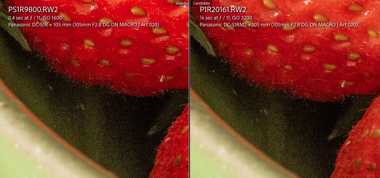

Now here's a comparison of ISO 1600 on the S1R with ISO 3200 on the S1Rii:

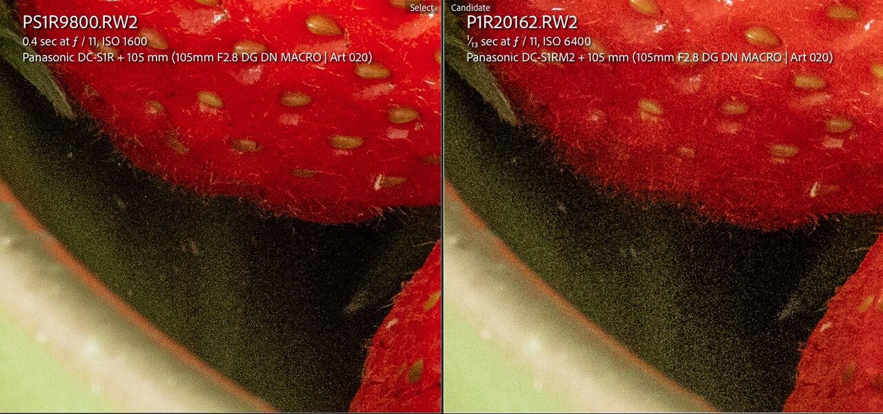

And now ISO 1600 on the S1R with 6400 on the S1Rii:
Bear in mind too that the S1Rii is 0.5 stop more sensitive and what we can clearly see is a 1.5 to 2 stop improvement in ISO performance from the S1Rii. That's pretty impressive.

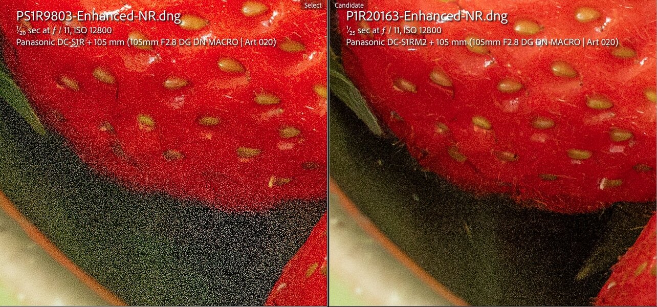

Of course, a bit of LR NR and we can get another 2 stops with both quite easily. But the S1Rii will always be 2 stops ahead. For example, here is ISO 12800 with 20% NR applied:
My take away from all this is that for high quality, low noise shots where a bit of shadow-pushing is needed (i.e. most landscape shooting) then ISO 1600 really is the tops for the S1R, but I'd be happy to go to ISO 6400 with the S1Rii. Whilst it could be argued that no-one would ever shoot landscape at anything other than base ISO, this assumes that a tripod is always at hand. Sometimes that's not always possible or convenient.
