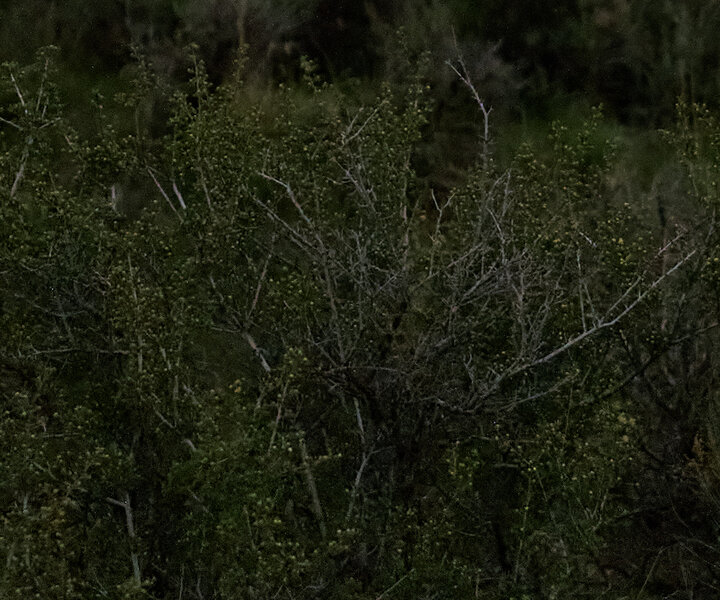

Here is an example from an astro shoot I did over the weekend. Foreground (obviously).
This is 60 seconds, ISO 400, +2.26 on the exposure, +30 on the blacks, and a nudge on Brightness to boot. 100% crop. Standard NR settings, no single-pixel NR.
