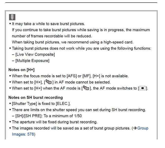

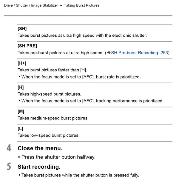

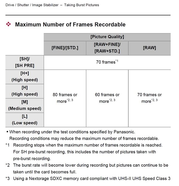

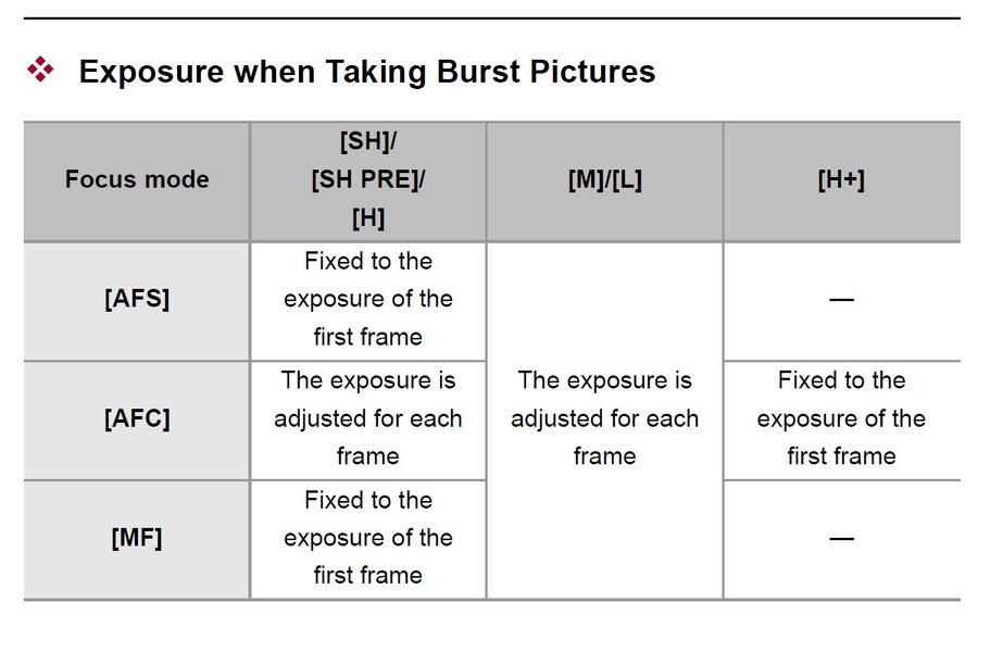

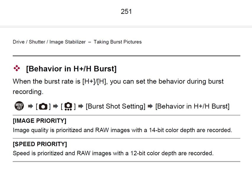

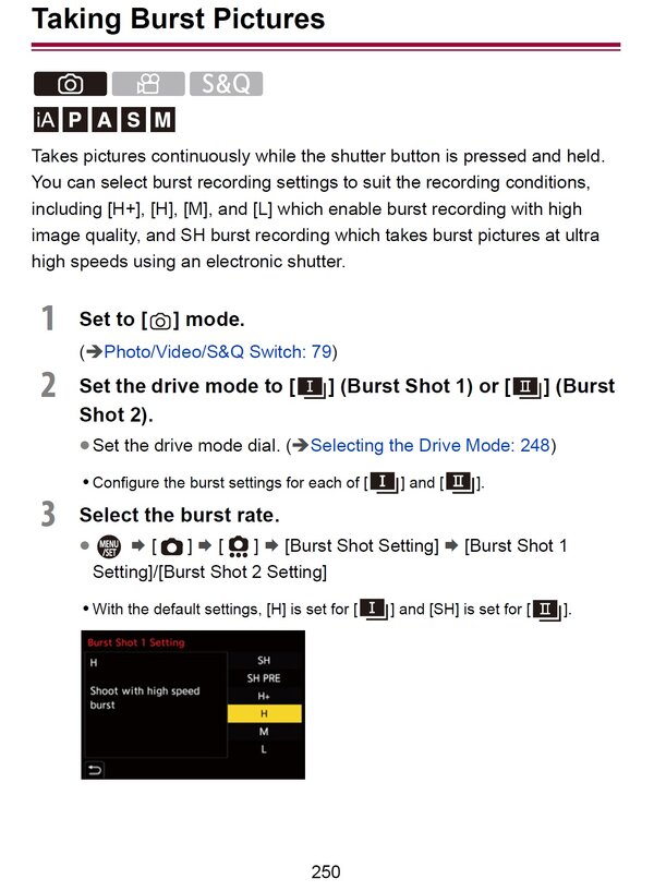

First, let's have a look at what the manual sais. This is a good starting point to get familar with the different alternatives.

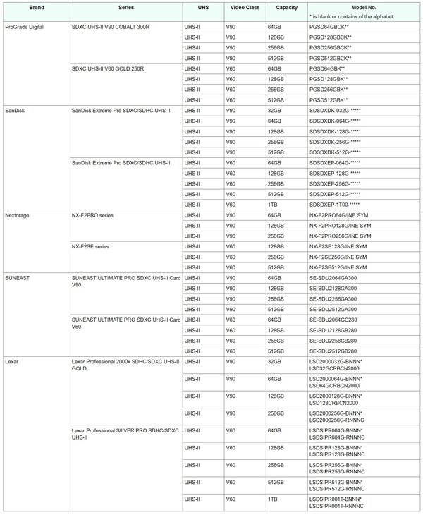

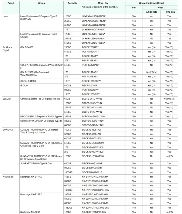

here is an explanation about the possibility to change the AF sensitivity of the Lumix S1Rii, which is neutral as default:
Regarding cards for the S1RM2, here is a link the cards that Panasonic says are compatible:
DC-S1RM2 Compatibilities of Storage Devices
Sean mentioned in a recent webcast that S1RM2 owners should refer to this list because using non-compatible cards may lead to premature overheating of the camera.
ok, my cards are really old (around 5 years). They are not listed there anymore. The new SD card standard is V90II, That is 300MB/s read & 260MB/s write, For video, CFexpress is the better choice, but I do not need it for video, only for sports photography and there will be no overheating risk in my view.
The newer V90II generation of Sandisk Extreme Pro cards is quite expensive...
For CFexpress, only the most expensive Sandisk CFexpress cards (around 300€) can deliver on the Lumix S1RII. This is with 320GB, There is no 128GB card in that line. Only from other brands, There are many "no" or "*" with restrictions in this table...
The question is, whether the processor of the Lumix S1Rii can send/write faster than the read/write speed of my old CFexpress card with 1500MB/s - 800 MB/s
Yes, and it's important to read the footnotes. For most of the Prograde cards, it says that you must update the firmware of the card for it to be acceptable for the demanding video modes. Before seeing this table, I didn't even know you could do that to a CFe card. Turns out it is specific to ProGrade, and you need one of their readers to do that. Fortunately I already have a ProGrade reader (they are fast!) so I decided to go with a ProGrade card, as they are both fast and reasonably cool. But, again, I'm waiting to see if their high sustained write performance has any impact in the S1R II.
The Sandisk Pro Cinema cards were called out specifically by Sean as being good, and these were the cards that were being given away with Pre-orders in the U.S. I filled out my form but never received the follow-up email that gives you the code to use in the SanDisk website. So I ordered the ProGrade, as I wanted a 1 TB card anyway.
I will reformat my cards, but I doubt that I will buy new cards. I will rather wait until i see that I really need faster cards. Til then prices might be even cheaper or new brands with cheaper products might be added to that list.

  • I set "image priority" in the menu for the burst mode settings, not "speed priority"

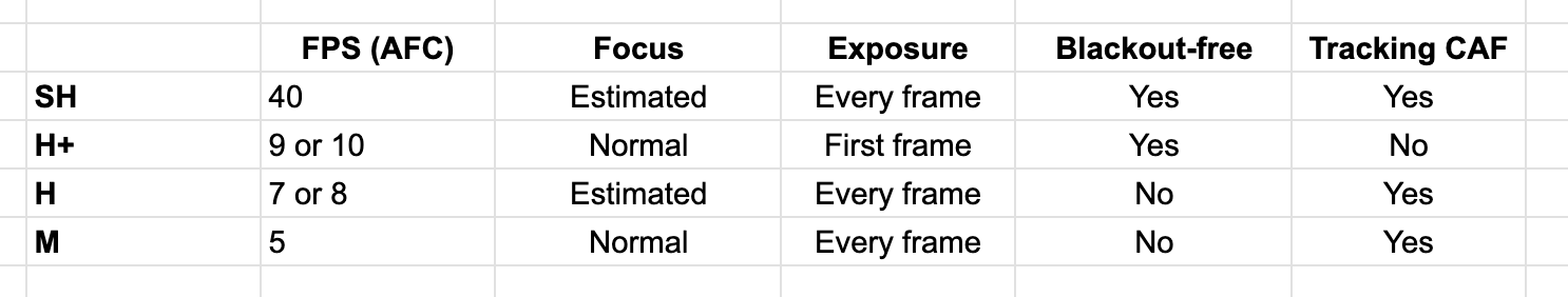

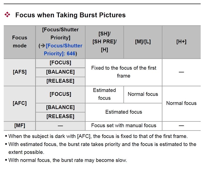

For the record, H+ gives you blackout-free shooting; H does not, making it harder to follow the action. The "Live View" column in the above table is a bit confusing.
H+ also gives you "normal" AF, while H gives you "Estimated." However, H gives you updated exposure with every frame, while with H+, your exposure is locked by the first frame. Additionally, H gives you tracking while H+ does not - you have to rely on subject detection whilst choosing one of the AF modes other than tracking.

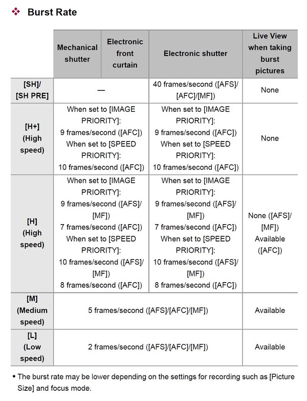

It's all quite confusing. Here is a table I have made that should help:
I found H+ to work well in the velodrome time trials, but in hockey the need for tracking might be more important than a blackout-free experience. I'd suggest trying both; it would be good to hear what worked best for you.

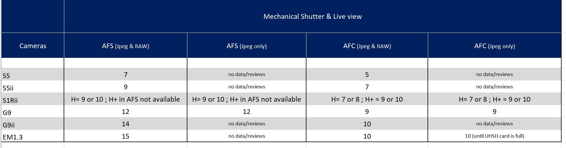

I compared other cameras with the S1Rii regarding burst mode.
It is intersting, that the S1Rii has the same burst speed with Jpeg only as with RAW & Jepg at the same time. Only the clearing of the buffer takes longer. Twice as long. For 33 images around 10 seconds instead of 5.
But this could be also the fault of my old CFexpress card. newer, faster CFexpress card might empty the buffer twice as fast, because of their almost 2x write speed.
It is impressive how fast the old Lumix G9 and Olympus EM1 Markt iii is. Of course it is a smaller sensor and less MP. But if you do not need fullframe, you can not beat the Oly EM1.3

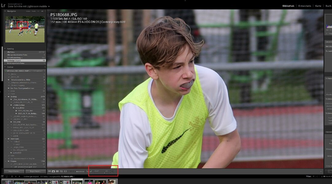

I do not know anymore whether the camera confirmed eye/face detection with the image below. It seems blurry due to low SS, but the face is the sharpest area.
This is in LR a 3:1 enlargement. With higher SS, it would have looked better IMHO.
