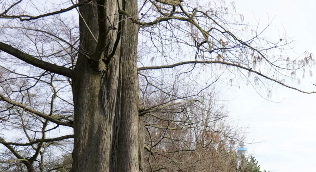

I've been scouting some sample images at full size. There are a few provided in the Digital Camera World review:
This one at 28mm and f4 is pretty awful:
Here's an edge view at 100%:
That's truly awful!
Of course, it's hard to know where the focus point is, so it could be a poor example - but OTOH, central parts of the image look OK and the subject distance looks comparable.
But even ignoring potential focus problems, the fringing is absolutely terrible.
