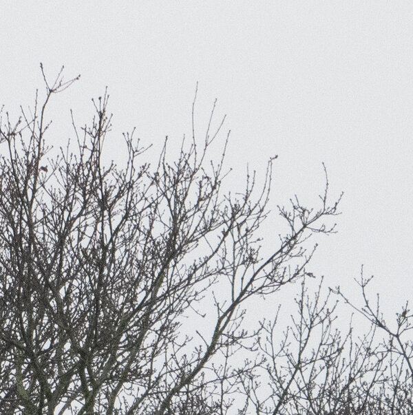

In each case, I took 10 shots of some trees about 500m away against a grey sky. Focus was re-acquired between each.
Here's a view of the scene (un-cropped image). Focus was on the branches at the top middle against the sky.

I classified the resulting shots either as:
- Fully sharp
- Slightly blurred
- Unacceptably blurred
This is "fully sharp":
This is "unacceptably blurred":
"Slightly blurred" is somewhere in between.
