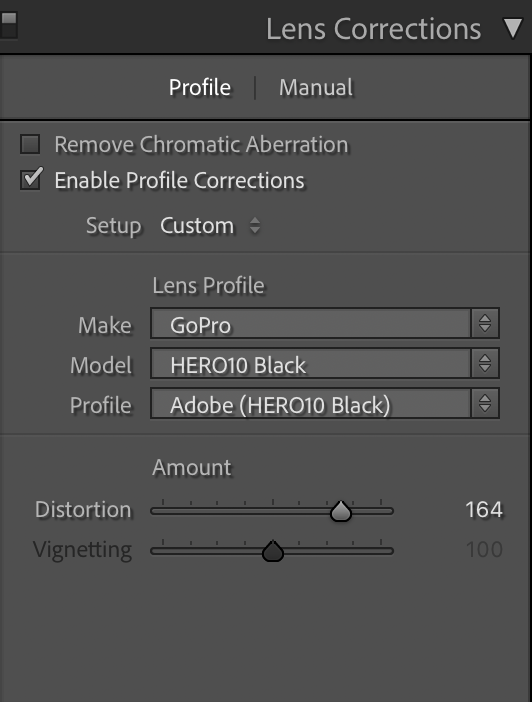

I got the TTArtisan 11mm f2.8 today, and had some fun shooting a few pictures with it, working in 65:24 aspect ratio. And then I wondered if the fisheye distortion could be fixed, so it would look like a 11mm wide angle lens instead of a fisheye. In Lightroom I went to <Lens Corrections><Profile><Setup: Custom><Make: GoPro><Model HERO10 Black><Profile Adobe (HERO10 Black)><Amount Distortion ~164>. And wala it worked, very nice wide angle images.
Useful tip. I’ve found that the Nikon fisheye correction works well too.

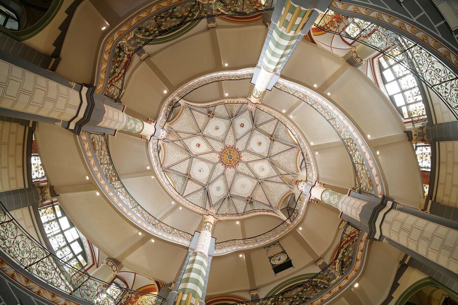

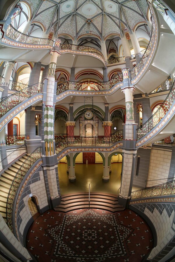

2 Pictures with the TTArtisan 11mm Fisheye from a court hall:

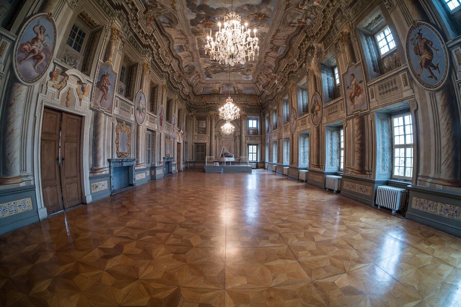

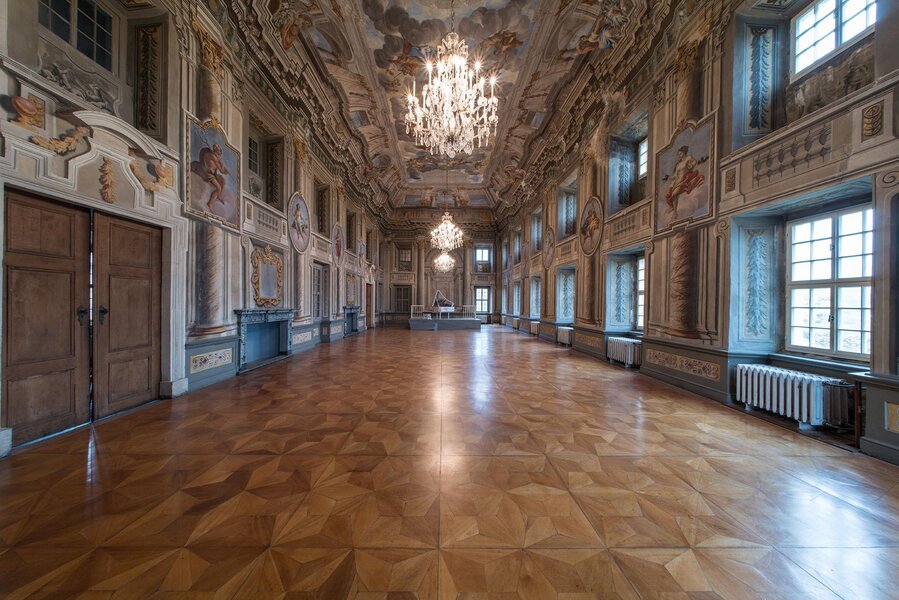

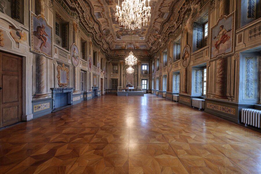

I made some comparisons how the TTArtisan works for interiors:
1. Picture TTArtisan 2.8/15mm Fisheye out of Cam
2. Defished with Fisheye Hemi (only vertical lines are defished)
3. Defished with Canon EF 2.8/15mm Fisheye Profile (more parts are cropped at the side, but horizontal lines are straight)
4. Picture from Sigma 14-14 DG DN at 14mm out of Cam
Result: Even with correct defishing the angle of the Fisheye is wider than a real 14mm. If you use the semidefishing from Fisheye Hemi it is even wider, with only small crops to the original. For me the lines on the ground are not so important as the vertical lines from the walls. So this is a very helpful tool!
The sharpness and contrast of the Sigma is visible better, but there are options in photoshop. At the end I have no problems to use the TTArtisan if I need the angle of view.
