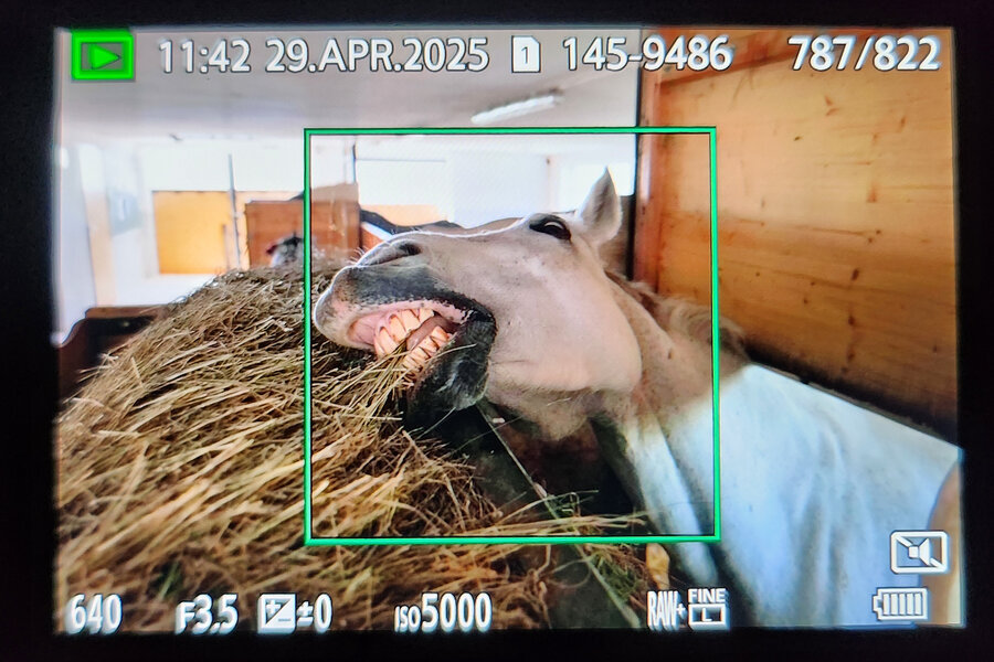

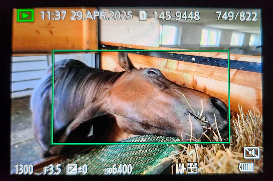

I used the 1-Area(Human/Animal Detect) for this pictures of horses with very low light. The S5 managed to focus horses even in the strangest positions...
I normally use the 1-Area(Human/Animal Detect) because the AF Area is bigger than the AF Area of the 1-Area+, isn"t it?
I will try to edit the pictures property later...
