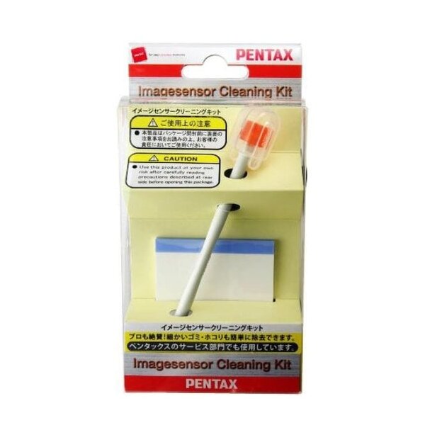

Less stubborn marks I used a rocket blower or if you don't want to wet clean I have the excellent Pentax dry cleaning kit which uses sticky pads and and a "presser device" you press lightly on then remove it to the sterile sipplied sticky pads, not dragging across the sensor as wet cleaning requires.
The Pentax kit is not cheap but a specialist product and it will last you years, I got mine over a decade ago and still have most of the sticky pads left Daumenhoch

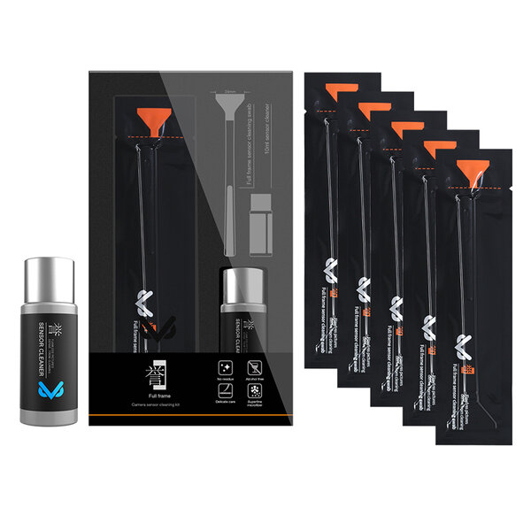

I've only had to wet-clean my S5II sensor once, just recently.
I used this product: VSGO VS-S03E:
The swabs are only used once, and you only put one drop of liquid on it.
I was worried about doing it but it was easy and effective.
Looks interesting. This is available on Amazon, for $23.59 USD. With mostly very good reviews.
Yes, I had looked at the reviews and also some YouTube videos showing how to use it.
I liked that it was simple and that the swaps are the width of the sensor. You just put one drop of liquid and give it a few seconds to absorb, then wipe along the sensor in one direction and then back again using the opposite side. Done!

Yeah, that is what I used for wet. It was separate solution and the sealed disposable swab sticks are great.
I think some freak out with the word "wet" thinking of water and damaging electronics. The supplied solution won't do that.
