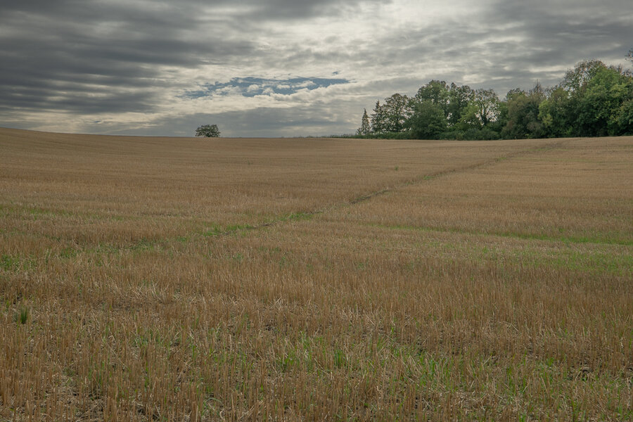

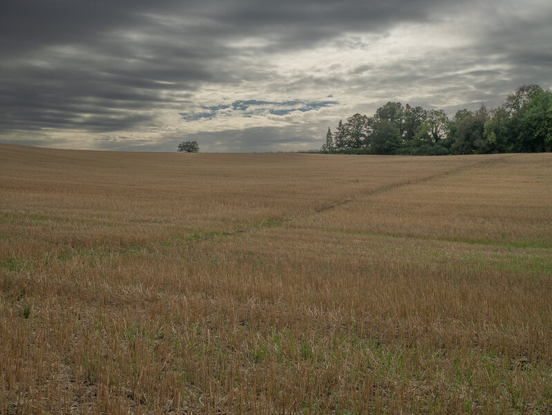

Pushing shadows

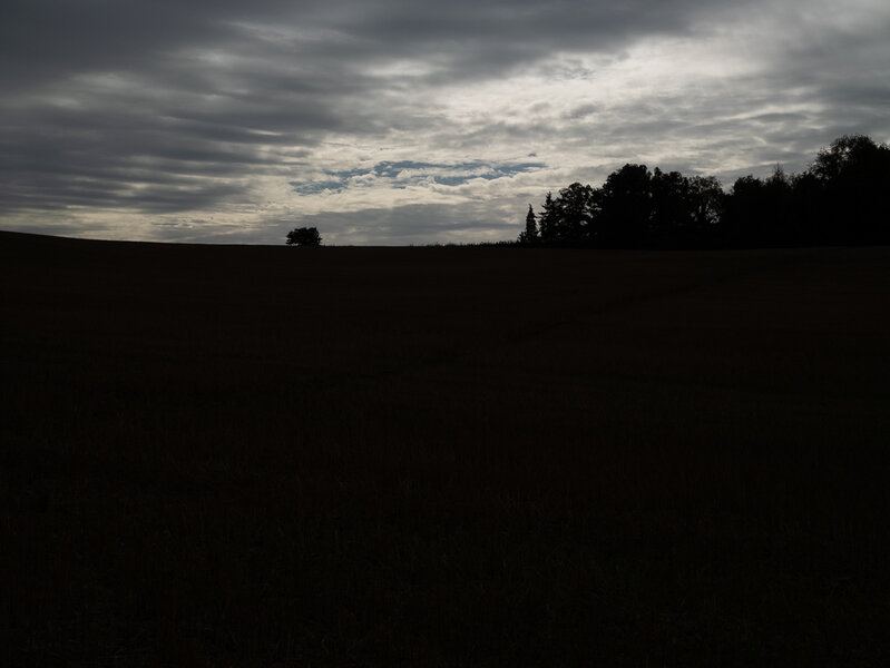

I shot this scene with all three cameras at their base ISO:
I exposed to keep the sky well within clipping. I could perhaps have added an extra stop of exposure without losing highlight detail, but I wanted to do a stress test on shadow pushing.

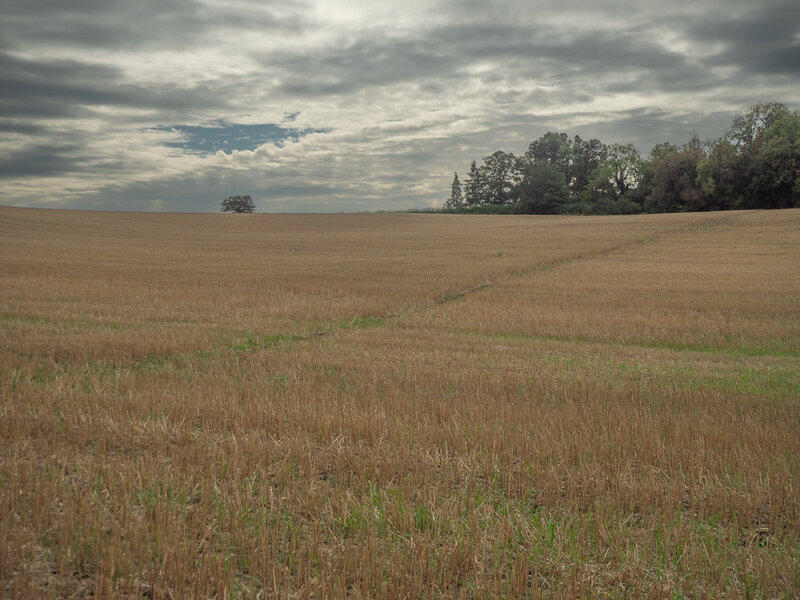

On all three cameras, I did this:
- Pushed shadows +100
- Selected the foreground (everything but the sky) and pushed that 1.8 stops
This gives a more-or-less normal brightness for the foreground. Now you might think this is an unrealistic thing to do, but it's something that can happen very easily on, say, a sunrise or sunset (after the sun has disappeared, I'm not talking of having the sun itself in shot). I could shoot a bracket of course, but if the shot is a long-exposure, this isn't usually practical. This is the sort of use case that led me to move away from m43 a couple of years ago.
And this is the result:
GX8:
G9ii:
S5:
I think it's pretty obvious that the S5 is the best - least noise and least colour shift. But the G9ii does OK.

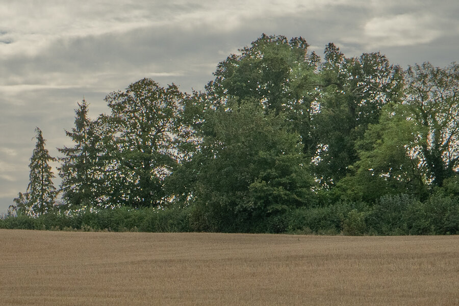

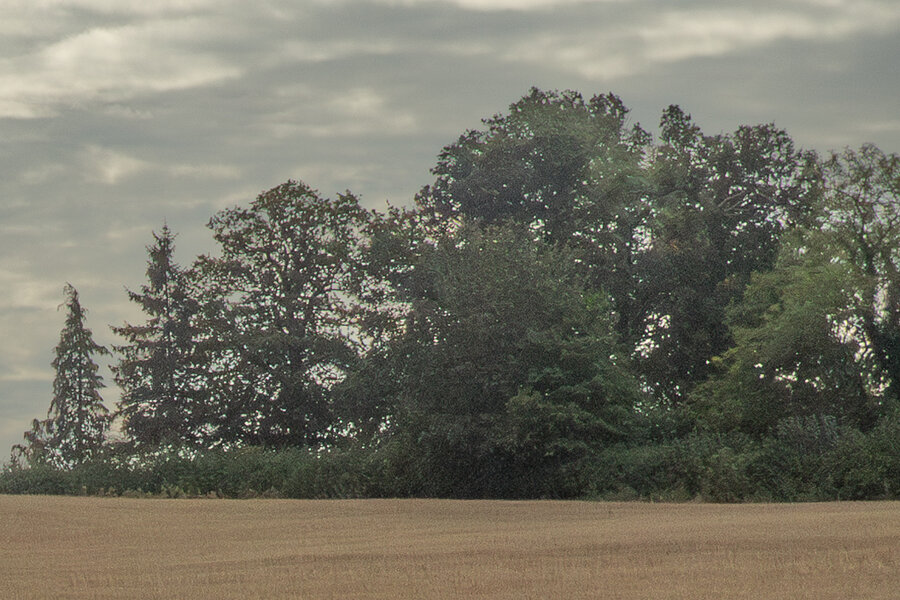

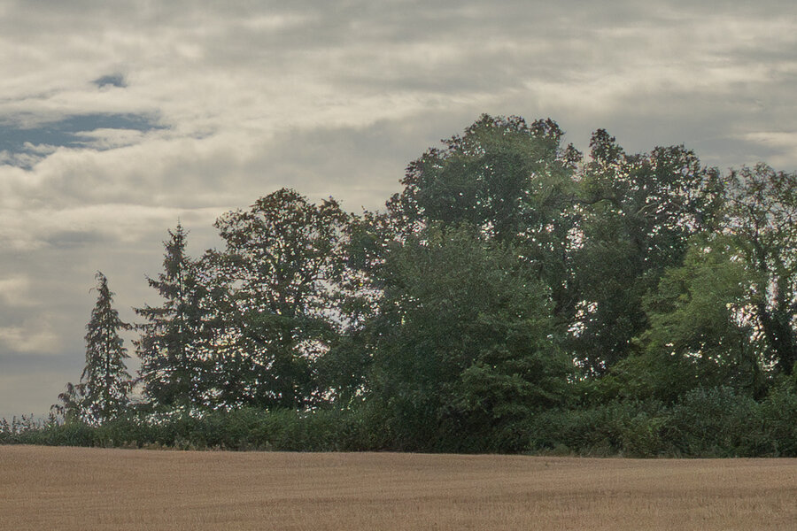

Looking at the trees on the right at 100%, this is what we see:
GX8:
G9ii
S5:

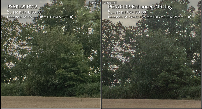

Let's see what happens if I clean the m43 images up using LR's NR (with NR set at 25%):
GX8:
G9ii:

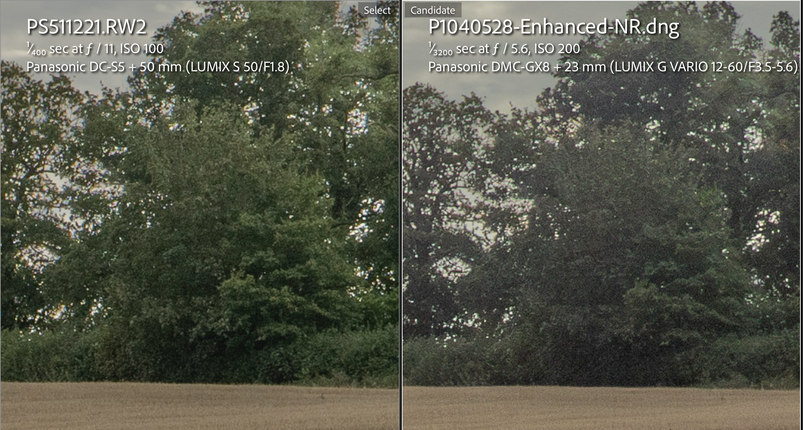

So now we're getting a decent shot off the g9ii. Here it is side-by-side with the S5 (un-enhanced):
The GX8 is still showing too much colour loss as well as a blue/magenta shift, but I've hit the limit of 10 attached images so I'll post it in the next message.
Now, I know that the GX8 is an older m43 camera. But I do know that its sensor is pretty much the same as in the Pen-F. I've run a Pen-F against an EM1.3 and for sure the EM1.3 is a little better. But my recollection is that it is not as much of a step up as we're seeing in these G9ii images. I also did comparisons of the EM1.3 against the OM1 with this sort of testing and I couldn't see any meaningful difference. So my conclusion is that the G9ii is certainly the best m43 camera for landscape shooting.
Comparison of S5 with GX8 cleaned up:
