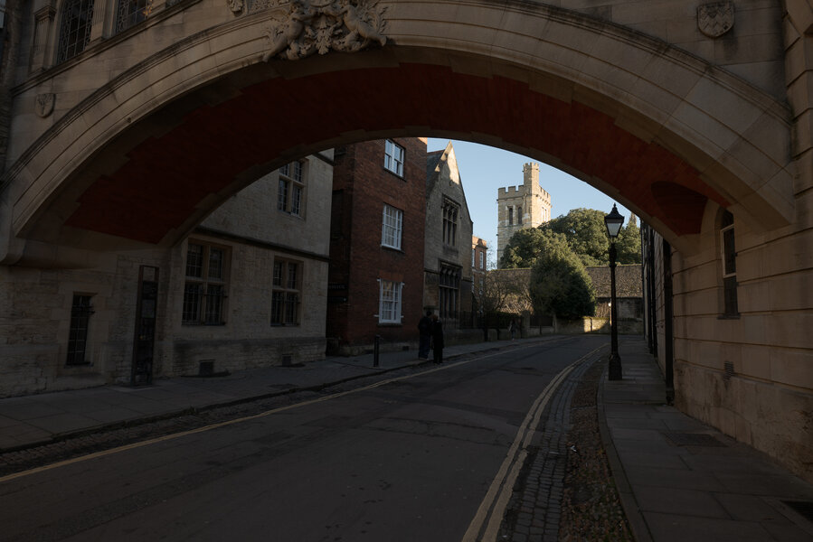

I got the chance to shoot a number of shots side by side with my S1R and a Sony A7CR. The Sony has the 60Mp BSI sensor that I think is the same/very close to the one used in the Leica Q3 and SL3, and probably what will be used in any subsequent S1R mark ii. Of course, no one will officially confirm this, but I think it's unlikely that more than one 60Mp FF sensor is made by anyone other than Sony Semiconductor Solutions. This is the same view that DPR came to in their comparison article between the A7RV and the SL3 that you can find here => https://www.dpreview.com/articles/4324053304/leica-sl3-vs-sony-a7rv?slide=2.
I only got chance to shoot at base ISO, so these are not high ISO comparisons. However, the shots were taken in very contrasty conditions, so the exposures were made to preserve highlights, necessitating a lot of shadow pushing, which is a realistic situation for landscape and similar photography types.
I'll use this shot to illustrate the points that follow. Exposure was 1/50 at f8. ISO was 100 on the S1R and 125 on the A7CR. I screwed up not using 100 on the Sony - it is as it is! It's only 1/4 stop difference so I don't think it totally invalidates the test.
1) Raw file rendered by LR using defaults and the "Adobe Neutral" profile:
S1R
A7CR:

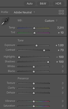

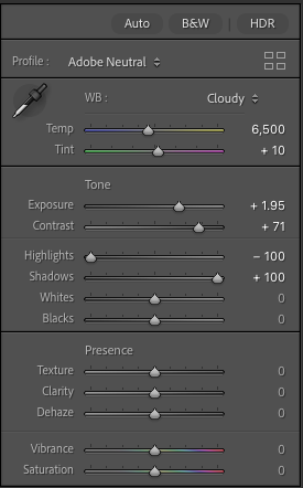

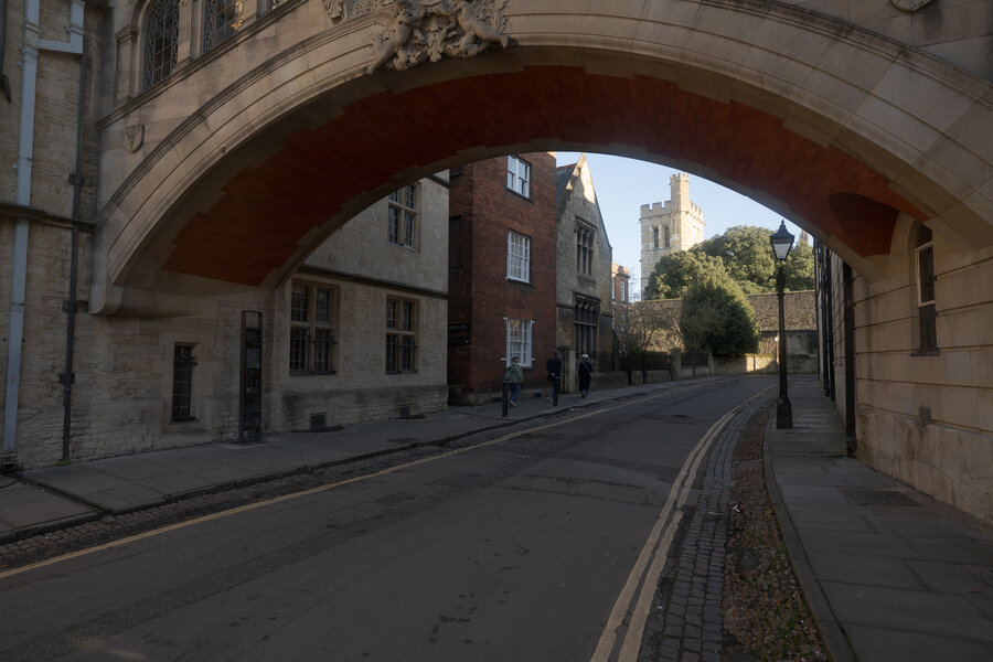

2) After edits to my taste (basic tone tweaking only, no masking):
S1R:
A7CR
My observations are this:
3) Noise

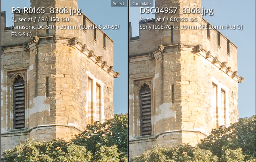

There is really zero practical difference in noise between the two cameras at base ISO, even when pushing the exposure/shadows a lot. Both show some mild noise under heavy pushing (worse than on the 24Mp sensor of the S1/S5/S5ii/S9), but it's easily cleaned up and only really visible when pixel peeking. Here is a 100% crop of a dark area of the processed images when exported at 47Mp:
3) Highlight recovery
The S1R is marginally better at highlight recovery in my processed example. Now, both shots have had positive EV correction applied - almost 2 stops for the S1R and 1 stop for the A7CR. I've also pulled highlights back -100%. Despite the more aggressive exposure correction to the S1R, the Sony does worse. This could all be explained by ISO calibration and/or LR's processing of the raws. For sure, if I remove the +1EV correction on the Sony, then the hot highlights come under control, but then I can't get the overall scene brightness right using the shadow slider alone. Of course, selective EV correction (by using masks) would fix this. Bottom line for me is that the Sony seems to be brighter than ISO 100/125 difference can account for.
4) Sharpness
You can see from the above images that there is really nothing between them in terms of sharpness. The little 20-60 at 20mm is punching at the same level as the Sony G 20mm f1.8, when both are at f8.

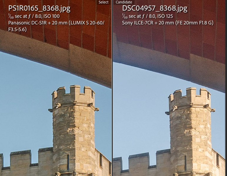

5) Strange light bleed on A7CR
There is a strange light bleed on the A7CR images on high-contrast edges (it was present on all of them I took, not just this one). This is the edge of the bridge:
This certainly isn't right. I don't know whether it's some lens flare, some sensor "blooming", or perhaps some filter effect. It needs more investigation.
6) Conclusion
Based on these base ISO tests shooting high-contrast, high DR scenes, there is really nothing between the cameras in terms of IQ.
The S1R is really an excellent camera for landscape work. I also find the shooting experience with the S1R to be absolutely superb. Weight aside, there is little to complain about with the S1R.
Thanks for this comparison. I think this light bleed is lens flare. It is surprising that a 20-60mm zoom has less lens flare than a 20mm FFL though.

The highlight recovery difference in the other image is not marginal in my view and there is lens flare too, by the way...
