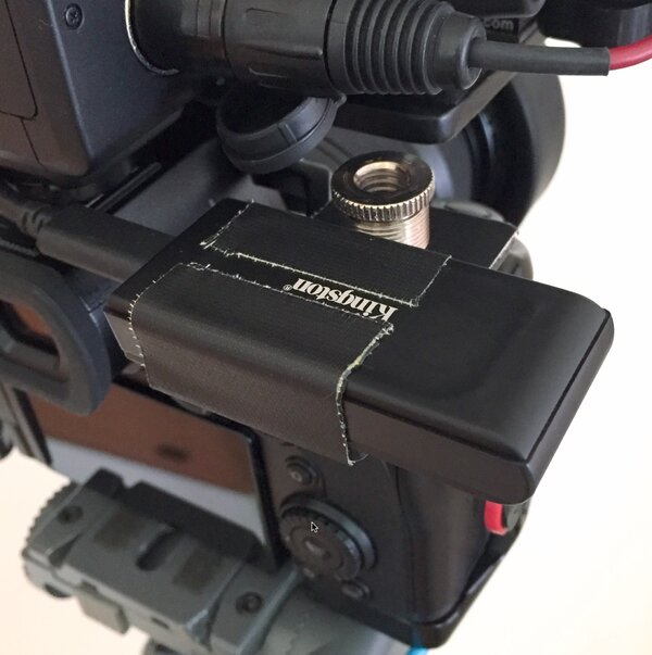

However, since ProRes 422 files are so much larger than h265, I needed to buy a bigger SSD. I'm aware Panasonic recommends a different drive than the one I bought, but I'm fairly certain the one I bought (Kingston SX1000 2TB) will work fine. When I test it using Blackmagic DiskSpeedTest, it reports the drive can record 4K 60p "ProRes _HQ_" without a problem. Note the data rate of ProRes _HQ_ is much higher than ProRes _422_, so it should work fine.
The Kingston 2TB SSD drive has a metal housing. To mount it on my camera, and to help keep the drive cool, I used gaffer tape to very securely attach it to a small metal plate, which in turn is mounted on one of the SmallRig cage cold shoes. The metal-to-metal contact should act as an effective heatsink. Refer to the photo below.

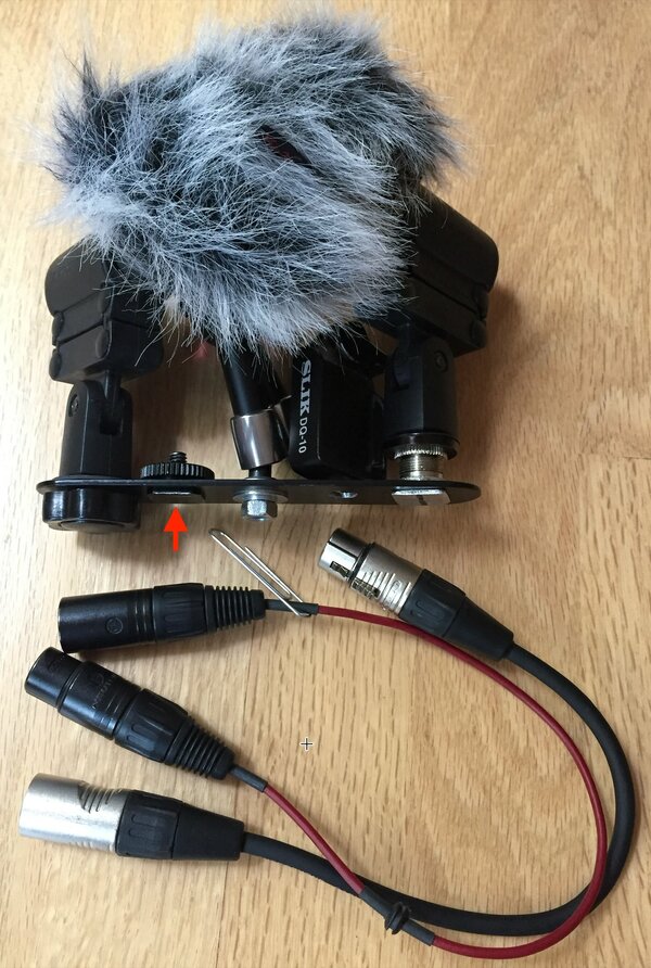

The stereo microphone rig consisting of a pair of MXL-606 mics on Sennheiser isolation mounts, plus the magic arm for the sun shade if required, are mounted via a cold shoe (note the red arrow in the photo). No tools required, and it easily fits in my backpack with the camera & other items.
The all-important paperclip visible in the photo is for adjusting the PAD/roll-off micro-switches on the barrels of the microphones. :)

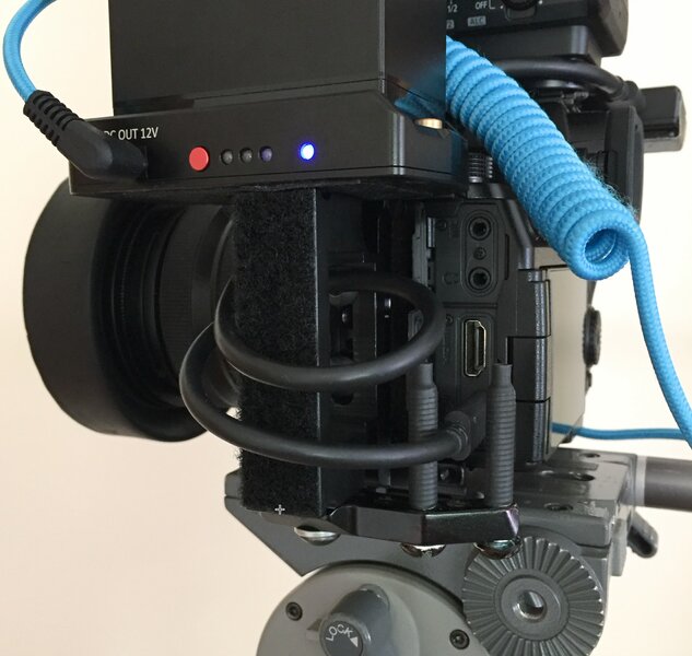

Another small but potentially important detail: I improved the physical protection for the USB-C cable connection on my camera.
As far as I can tell, SmallRig doesn't sell a cable-clamp for the specific SmallRig model cage I own. So that's why I improvised the following solution.
I added a small metal "arm" which has multiple 1/4-20 threaded holes in it (this was a scrap metal item which I cut & shaped to fit). I put two 1.5" bolts up through two of the threaded holes to act as cable "guides", and covered the bolt threads with heat-shrink tubing so they don't damage the USB-C cable. Then I bolted the arm to the bottom of a bracket which I'd previously added to the side of the cage (the bracket which holds the SmallRig NPF battery plate).
The result isn't perfect, but it does help protect the USB-C cable/connection from the bottom & sides. I later plan to replace the 1.5" bolts with 3" bolts (covered with heat-shrink tubing) to similarly protect the HDMI, headphone & mic input connections.

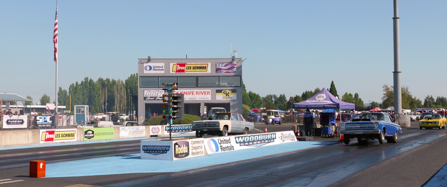

Today's video shoot in Woodburn, Oregon went well, considering it was very hot trackside (>100F). No technical issues with my S5iiX rig. I shot about 180 video clips (4K DCI 60p ProRes 422), plus a few dozen hi-res 96MP stills. My friend Sam shot a similar quantity with his S5iiX. It'll take us a while to sort through it all, but here's a random frame from one of my video clips, and a couple of stills. We got shots from many different angles (not shown here). There were many, many cool cars to see! More later.

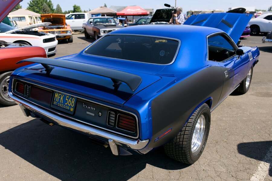

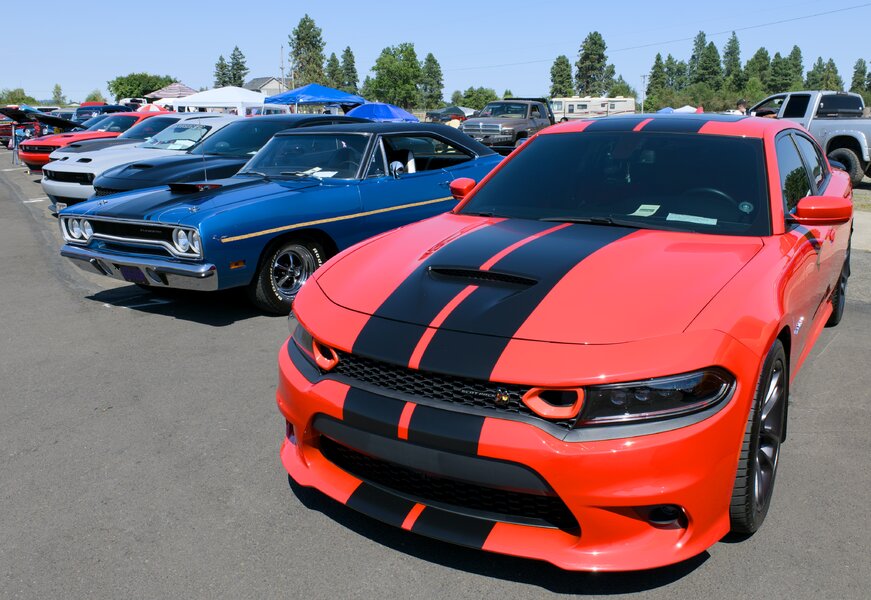

Many, many, cool cars (these images are compressed from hi-res RAW stills) ...
