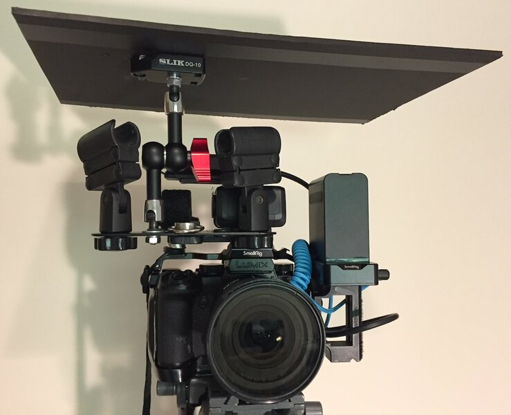

OK, I made a sun shade for the camera in case I need it on a hot sunny day. It's a 10" x 15" piece of white foam core, which I spray-painted flat black on the underside. I left the top side white to reflect the sunlight. It's mounted to the SmallRig cage via a short magic arm and quick release. Very secure & doesn't flop around. The magic arm enables the sun shade to be easily adjusted. I can also use it as a French flag to prevent lens flares, and the white side can be used to do a manual white balance. The sun shade fits in my backpack & weighs almost nothing, so can be kept stowed away when I don't need it. Of course, if it's very windy I probably wouldn't want to use it because it might cause the camera/tripod to shake. Since I already had the magic arm & foam core, this is a no-cost shady "accessory". :cool:
In this photo you can also see how the 2 mic clips are mounted. The 2-mic bracket & magic arm are bolted to the custom L-shaped bracket I recently made. Very sturdy & secure, but easy to remove/install without tools.
Here's another view. I purchased the mics a few days ago, and they're due to be delivered in a day or two. After I rig them up I'll post another pic.

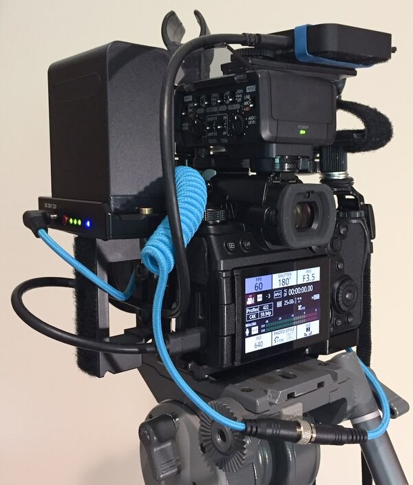

Also: Sam's S5iiX camera & SmallRig cage won't be quite as rigged-up as mine. He'll use an external SSD, 1 external Sennheiser shotgun mic, DMW-XLR1 audio adapter, 2 internal batteries, and the Lumix 20-60mm & 50mm lenses. All the same settings. No sun shade. His config will be a good "control group" vs. mine. Will be interesting to see how the results we get compare to one another.

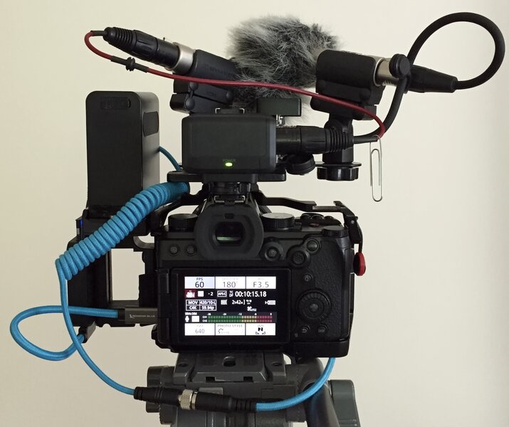

The 2 mics ("MXL 606 cardioid") were delivered from B&H today. They seem to work fine, and I like that they're relatively small & lightweight. Each mic has 2 built-in switches for low-frequency roll-off & -20db attenuation. I also received 2 short 1' long XLR mic cables, which are the perfect length for on-camera use. The 2 fur windscreens in the photo were purchased from B&H many years ago. Now that the rig is complete, I'll give it another sound & video test next Tuesday, again using Sam's diesel pickup truck as the loud noise source. (That's the old Nikkor 70-210mm f4.5 manual lens in the photo.)

Can anyone guess what the paperclip is for? (This is not a trick question.) Z04 Breakdance.gif

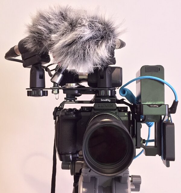

I continue to tweak the rig configuration. I adjusted the mic bracket so it protrudes about 1" less from the grip-side of the camera. Now the mics are bit more centered over the camera. At some point I should substitute a right-angle XLR plug on the left channel [black] mic cable so it protrudes even less. I remembered I've long-owned a short RED 1-ft. XLR cable, so I've now connected the right-channel mic with it. I removed my improvised XLR cable "strain relief" support, which was next to the input side of the Panasonic audio adapter. I decided the short XLR cables are lightweight enough that the extra support isn't needed. I installed Peak v4 camera strap anchors so I can add/remove my Lumix shoulder strap easily. I haven't decided if I should relocate the external SSD to the cold shoe above the shutter button (probably a good idea). Maybe I have "ADHD"? Z04 Flucht
