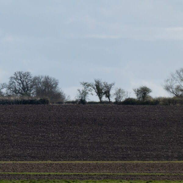

But it seems they've sent me a lemon. It looks absolutely brand new - everything is pristine with no signs of use or abuse on it at all. Even the caps are devoid of scuffs and scrathes. But it's got terrible performance on the right edge. Here's an example.
Full frame - focus is in the middle on the trees. Shot at ISO 100 on the S1R. 1/200S AT F8.

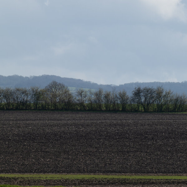

Here are 100% crops of the left edge, middle and right edge:
I'm really not going to learn anything from this copy!
Have you sent one picture twice? The left edge and the middle is identical.
The right corner looks really blurred, so you most likely got a decentered copy, because the left corner looks fine (it looks like the double picture is the left side).

@RBecker & @Oíche - yes, you're both right. I can't call it a lemon until I do the testing more carefully. But, in my defence I'll just say that every single shot with it so far is showing right-hand side softness.

What about the details at the right corner?
The right hand side is very soft. I've done a bit more testing and I can quite plainly see that the focus point on the right hand side shifts significantly towards the camera. On some shots where the foreground is nearer than the main part of the image, the right corner looks sharp, but the right middle edge is smeared! On the left, it's the other way around.
The it is quite clear, that this lens is not correct calibrated. You said you rented this lens. I would give this feedback with the expectation to get some refund or a new rent period with a new lens...
