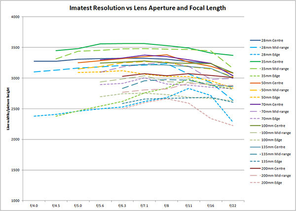

I just found this review, posted two days ago... Interesting part is the resolution vs aperture chart. I already wanted this lens, that hasn't lessened with this review, quite the opposite.
Photo Review
Do in mind: I mostly do video with my S5iix (and S5). I see this as a travel lens, for other situations I have better options.
An interesting review. I'm noticing that reviews are not consistent. Richard Wong's review was positive, Jordan Drake's negative - for instance. I'm wondering if this is a lens with a lot of copy variation?
In terms of this review, I'm very encouraged by this:
Performance
Our Imatest tests showed the review lens to be a good performer for an extended-range zoom lens, even with the in-camera optical corrections disabled. While centre resolutions on JPEG files either met or came close to expectations for most aperture settings and measurements taken roughly mid-way between the centre and edge of the frame remained relatively high, edge softening was present throughout the focal length range.
RW2.RAW files converted into 16-bit TIFF format with Adobe Camera Raw delivered higher resolutions across the board in our tests. This is to be expected. The highest resolution measured was at f/6.3 with the 35mm focal length and diffraction only began to affect resolution from about f/11 onwards.
In essence, this lens scored Grade A ratings across all our assessment criteria. The graph of our test result below shows potential purchasers can use this lens with a fair degree of confidence in obtaining good results, whatever the focal length and aperture settings they choose.
