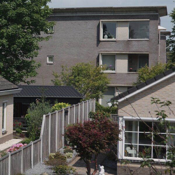

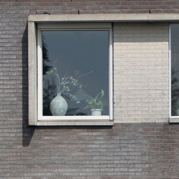

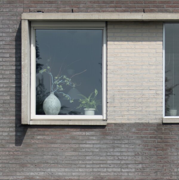

I think my copy has severe decentering. First is the left-side of the center, when turned the camera 90 degrees to the right. Same picture taken but then taken 90 degrees to the left, so the right side of the lens. These are 100% crops. After noticing it In casual snaps I did this twice, same result.
left side lens
If the lens performed like the bottom picture, I would really like it. Maybe I reorder it. I already mailed it back.
Mine does not have obvious signs of decentering, although at 170+mm I do need to stop it down a fair amount to keep good pixel-level sharpness. Out of curiosity, what focal length & aperture were you using in the above test shots?
This was 200 wide open, through my window on a building at infinity. But this is not about absolute sharpness but about the difference between left and right side of the lens. If it was like the 2nd picture I would be ok with the lens.
But I had taken some snapshots earlier and some of them included a brick wall and noticed the difference immediately. Then I shot a paper 200@f8 at mfd and noticed again sharp in the middle and sharp enough at the right, but softer on the left. Then I took these shots to confirm my suspicions. Twice.

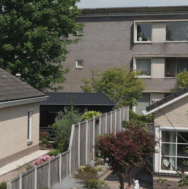

Just one more example... a 100% crop of my 24-60 and 28-200 @ 35mm, should be one of the better part of the focal range of the 28-2000. The 28-200 wide open at F4.5, 24-60 matching the aperture. Guess which is which... the crops are taken from the mid-right, it's not the corner, but right side of the image. This is 24mp, what happens at 44mp, then the difference between center sharpness and the rest of the image would be amplified. 24-60 has the slight disadvantage of having a uv filter from k&f. The lens was send back Friday, so can't do any more test. I'm wondering if I should try another sample...
If I look at image 29/72 from dpreview 28-200 review, I'm wondering if the performance I saw is default for this lens wide open... Never paid that much pixel peeping attention to dpreview :) but it is 35mm and 4.5, same as I used with the dull testshot of my neighbours house. As you can seen in that picture, mostly to the left, the bicycles are very soft. If someone can show pictures taken them self at 35 ( or < 50) wide open... that would be much appreciated. I thought the lens I got was a dud, but now I'm unsure if to get my money back, or have them send another copy.

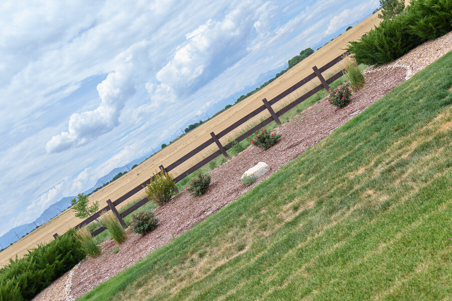

Here's a 35/4.5 test shot from my copy, using the S1RII. The corners are pretty soft, which is what I expect for this lens, at least when wide-open. Focus is on the fence in the center of the image. Lower left and upper right corners (the shrubs) should be same DOF as the focus point, more-or-less. Of course, the S1RII is working the lens pretty hard. But still, given the parameters of the lens, you can't expect it to have sharp corners wide-open.
You should be able to click into the image to SmugMug and download the full-res 16 MB file. If not, and you want to see it, let me know.

@GeorgeHudetz Thank you. Is this wide-open ? I asked for a new lens after I got a mail that stated "we have tested the product and it complies with our DOA-terms". So no charge for the return shipping. They will mail me a new lens. If I don't like that one either I will return it and going to stop finding a good sample. The crops I posted where not even from the corner... but more like half way from the center right at 35mm wide open. If it performs like yours (if this is wide-open) I would be more then fine with it.
Yes, wide-open.

It looks like that your left bottom corner is a bit worse then the top right... And I found he (i) button for the details, yes it is wide open.... and the same af F8 ? :cool:
Yes, wide-open.
Yes, I think there is a little de-centering, but not enough to bother me for this lens. I'm confident the corners sharpen up at F8. I'll try another shot tomorrow.
