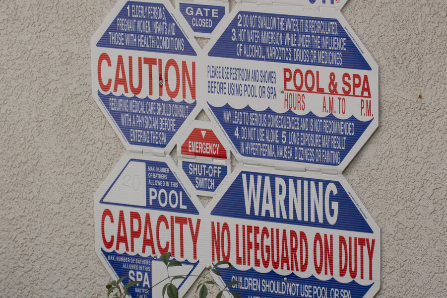

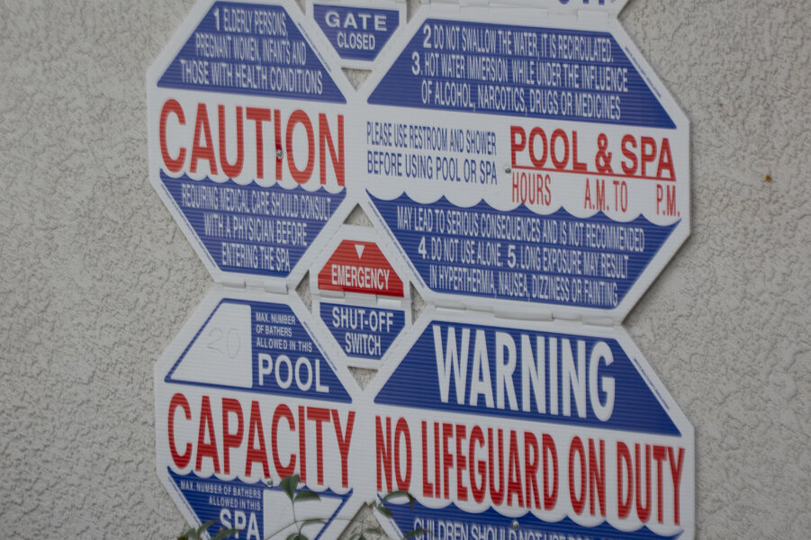

I've been running telephoto zoom lenses in the Hybrid Zoom mode, set to Minimum Image Size "S" which add a 2X zoom. This is great fun, and I'll post about it tomorrow.
Hybrid Zoom
The higher pixel count on the S1RII compared to the S5II or S9 means it has more pixels available for HybridZoom. With the Minimum Image Size set to "S", the image size zooms from 8144 x 5424 pixels (44.17 MB) down to 4128 x 2748 pixels (11.34 MB), which shows on the camera as an added X2 zoom. This happens smoothly as the lens is zoomed through its range. I looked at three zoom lenses, the 28-200mm, the 70-200mm f/4 and the 70-300mm. I also looked at the 70-200 with a 1.4x extender.
The 28-200mm becomes 28-400mm
The 70-200mm becomes 70-400mm
The 70-300mm becomes 70-600mm
The 70-200mm with a 1.4x extender becomes 98mm to 560mm
I took dozens of pictures, but I'll only show a few. The shots are RAW, and I used Lighroom to look at them. HybridZoom only works with JPEG, so to get RAW I shoot RAW + Fine, and I only took the RAW photos to Lightroom. When you open a photo it is scaled to the Hybrid Zoom focal length. But the entire picture is there as well, scaled to the native focal length without the Hybrid Zoom factor. The way to view the entire picture is to use the Crop Overlay button. This shows the entire picture, mostly greyed out, plus the smaller Hybrid Zoomed image not greyed out. Like with a normal crop in Lightroom you can move cropped region around, or change the crop size and shape if you want. Hit enter and it goes back to the Hybrid Zoom image. If you normally edit in Lightroom this probably makes sense - otherwise I'll move on.
The advantage of the 28-200 is that it is small and light. It was a medium performer, good enough I'll probably carry it on a hike now and then. The 70-300 had the worst performance. This was a surprise, I wanted it to perform well but it had a couple of problems. First, the stabilization did not work as well as the other two lenses and I felt I needed a little higher shutter speed. And when I did have it stable and focused well it was not as sharp as the 70-200 or the 70-200 with the 1.4x extender. The 70-200 was the superstar, with 400mm and 560mm images as sharp as I've ever seen with my back yard telephoto tests. Of course this lens is heavy; big and heavy. So I'm not taking it on a long hike.

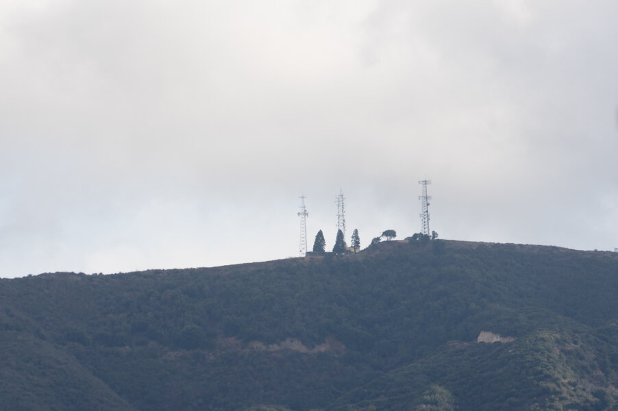

My usual telephoto test shot is some fire station antennas on a ridge about 1.1 miles (1.8 km) from my back yard. I'll just show one. This was with the 70-200 and the 1.4x extender (560mm equivalent). It was getting late in the day, with quite a few clouds around, so it isn't a pretty picture, but I only look at the antennas themselves. The detail on the antennas may be the best I've seen. (The photos shown here are scaled down to meet the forum size limits.)
I did a test to compare the 70-300 to 70-200 with 1.4x extender. For this I un-zoomed the 70-300 to 560mm equivalent.

The 70-200 with 1.4x extender is the clear winner here. The test had the same results with multiple shots.

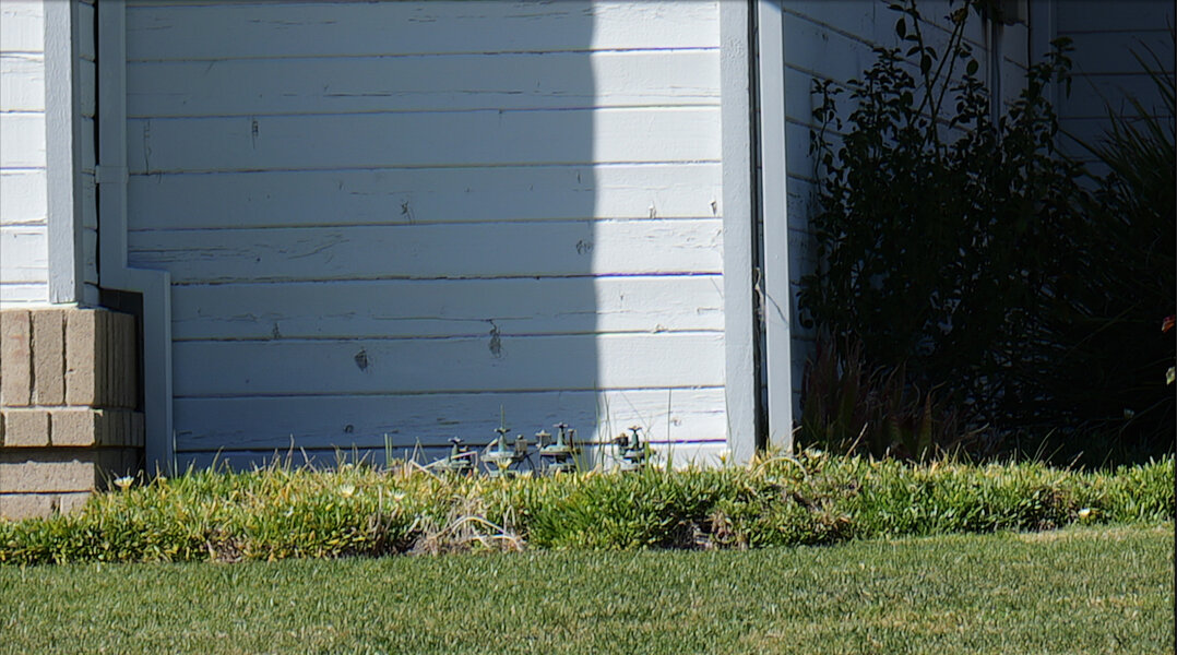

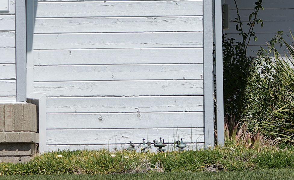

High Resolution mode
The high Resolution mode in the S1RM2 is close the same resolution as the camera I'm replacing, the Sony A1. The A1, and I believe all Sony cameras, require post processing for High Resolution. This makes it not very convenient; you save the stack of photos to your computer and import and process them in Sony software. I used this a few times over the years, but not very often - it was not worth the hassle. Panasonic processes this in the camera; it takes a few seconds but it is a far far better way. I took some test shots. First, I'm not very good with hand held high resolution - I'm not known for steady hands. So I used a tripod. I shot with RAW+Fine. Lightroom still doesn't process High Resolution RAW from the S1RM2, so I looked at the RAWs in Capture One. But I looked at the JPEGs in Lightroom, and that's what I'm showing below. When you take a High Resolution Picture, you get both the high resolution version and one of the normal resolution shots as well. (With RAW + Fine you get four pictures with every shot.) You can directly compare the normal 8144 x 5424 pixel image with the high resolution 16288 x 10848 pixel image, either RAW or Fine.
The picture was of a house, and in Lightroom I zoomed in on a small segment of the image, looking at some irrigation control valves. I expanded this to 200% for the high resolution image, and to get the same size I expanded the normal resolution image to 400%. This was with the 20-60mm lens, zoomed out to 50mm. This was at ISO 80, f/6.3 and 1/320 sec. The images are screen grabs from Lightroom.
Normal resolution (at 400%)
High Resolution (at 200%)
The conclusion, the High Resolution mode works well with the S1RM2. I expect to use it quite a bit. And the 20-60mm lens is awfully good. (Good at the center, it falls off at the edges.)
FWIW, the 20-60 has substantial field curvature, which is why the left and right edges can be soft while the fg corners are quite sharp. You can minimize this by stopping down and focusing at infinity. I get the best overall scene sharpness with the 20-60 at F11 with infinity focusing. Of course, this brings in diffraction, particularly on the 44 MP sensor, and while some of that can be overcome in post for a standard image, for a HR image the effects are much more obvious and Capture One is powerless to overcome it. It's for that reason that I do not use the 20-60 for HR shots (although if you are cropping into the center or otherwise cropping out the left and right edges it's not too bad at F8).
Also, you can see some purple fringing in your shot between the two siding board in the sun, and it's worse in the HR shot. Again using Capture One as the reference, I have found that it's Chromatic Aberration tool is ineffective on HR shots, so I tend to avoid lenses that show CA for HR work. The 16-35 S-Pro falls into this category as well, unfortunately.
Anyway, for HR shots, use the best lens you have. It really does make a difference. Or at least be aware of the limitations of whatever lens you have on hand.
I have the Sigma 50mm f/1.2 and I'll try that HR shot with it. What are your thoughts about the 24-105 for HR?
My 24-105 is certainly better. HR shots from that lens are very workable, IME. It's corner softness will be more obvious than a normal shot, however, but that's true for basically every lens that I've tested. Your 70-200 should do quite well as well. For UW I prefer my Sigma 14-24 F2.8 DG DN Art for HR work.
