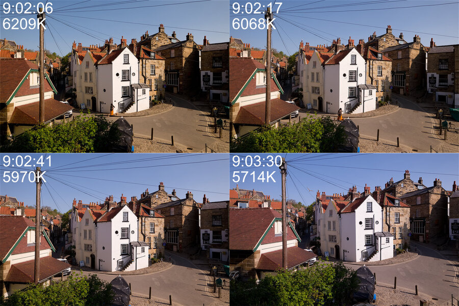

The white balance issue is really odd. It didn't happen in the first sets of photos I took, so I started looking for changes to the settings and examining all the photos I've taken with the camera. I found the following series taken yesterday as I waited for people to get out of the view, and then took another photo when a seagull flew into the frame to see if it'd be blurred by the electronic shutter. These are unmodified DNGs processed by Iridient Developer, and I've added the time and the White Balance values for each photo:
You can clearly see the white balance changing over a matter of 1 minute 24 seconds. The sky was completely clear and there was no change in the light as I took these photos.
I had the Sleep Timer set to 10 seconds (the default) to minimise the battery drain. I'd get the camera pointed in the general direction I wanted, wake it by half-pressing the shutter button, quickly frame the scene then half-press the shutter button again to see the AF Auto Review (which briefly turns on focus peaking and magnifies the focus point) and press the shutter button fully. It looks like half-pressing the shutter button locks the White Balance and I'm guessing I wasn't giving the camera enough time to determine the correct value.
The relative subtle changes by white balance are not surprising me at all.
Every picture do have another image field / composition.
So different "coloured" areas within the total image in what is used as for a "white balance" interpretation.
What white balance values are used when using a fixed camera setup on a tripod?
So no changes by image field / composition??
For a precise interpretation of the white balance with a "high degree of reliability".
"Calibrate" your camera using a "gray card" and use that setting for several pictures.
