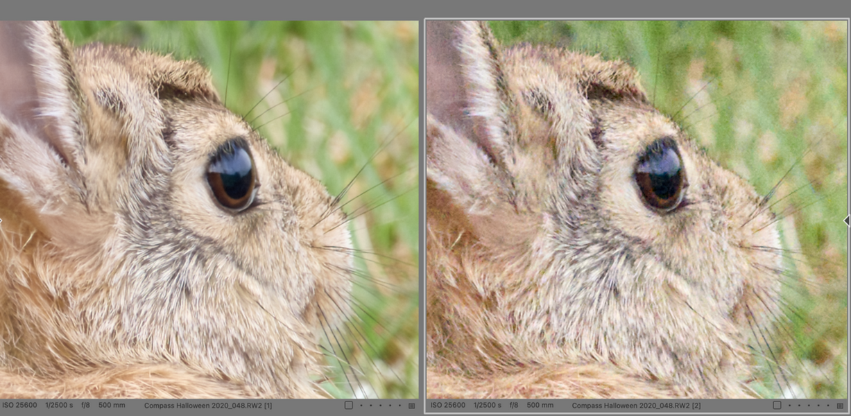

Decided to download the beta. Here’s a before & after. S1RII, ISO 25600. First image with denoise set to 50%, second image without denoise. Otherwise all defaults. Screen grab from my MacBook Pro @ 200%. The denoised image needs a bit of additional sharpening, which it accepted no problem.

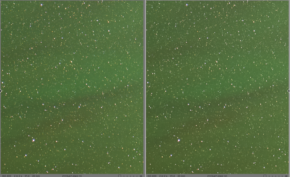

BTW, here is a C1 denoised astro image. On the left is the denoised image; 200% screen cap. ISO 400 & pushed one stop on the exposure slider and some further brightening & saturation tweaks. The difference isn’t huge, but then I don’t see any evidence of “star eating” but yet I can see regions that look cleaner. So that’s a win for me.

Also, I just compared an ISO 25600 image from the S1RII to the S5, and while C1 denoise helps allot with the splotchy character of high ISO S1RII images (due to the baked in NR, I presume), making it look a little more like old-fashioned noise, it’s CRAZY what C1 denoise does with the 24 MP image. Just nuts. (Although I’m sure the other packages have similar results).
Also, C1 denoise (beta) does leave behind some chroma noise with the S1RII image. Hopefully they can improve that, although again it might be down to the baked-in NR in the S1RII body. Not sure.
