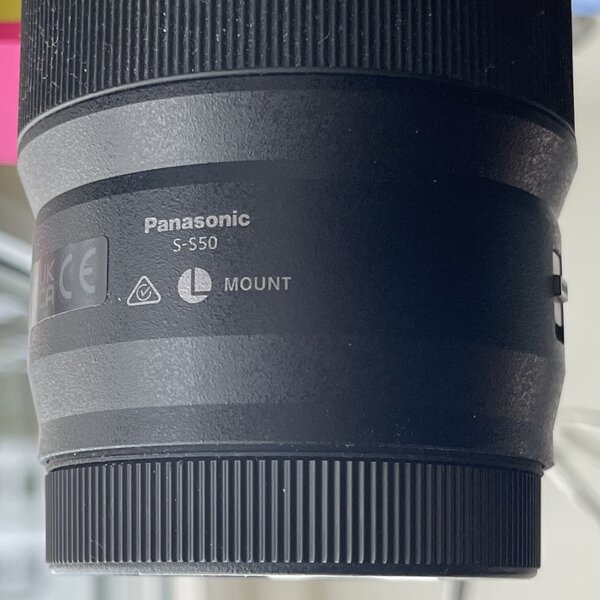

Same story for me. Upgraded my S5iiX today (January 27th, 2025) after Lumix released both the 5iiX 2.2 FW and the 50mm 1.1 FW. However, the spec's are type "need to know", as it's described as S-X50. No f-stop mentioned, no "pro" label, just S-X50. Even the camera-stores have no mention of a Lumix "S-X" type of lens. So, then I guess the S-50/f.1.8 will be labelled as a pure "S-50". Need to know. Anyways, the 2.2 camera FW brings to the table incredible new features. BR, ermesjo.
Thank you, Quentinquirelino and pdk42. Now that you guys have given us a crash-course 007 Agent training, we all know better! Remember, I am only a Lumix baby, 3 months old since I got my S5iiX in October 2024 (my 40 years experience with Canon EOS does not count here...). Next thing now is to wait for the S-S50 version 1.1 firmware :) LOL. It's nifty, the Lumix stuff, but all the parameters needs to be digested only by a mouthful at a time ... Daumenhoch
