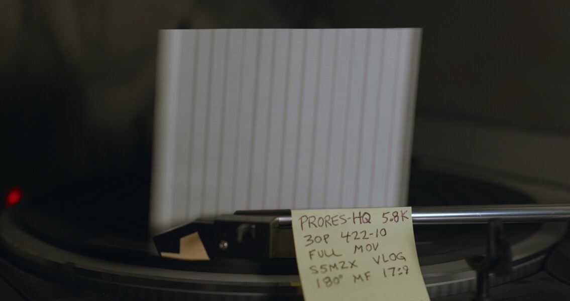

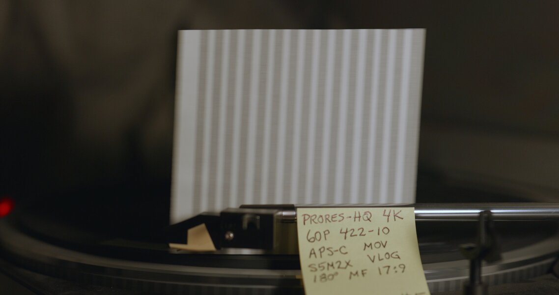

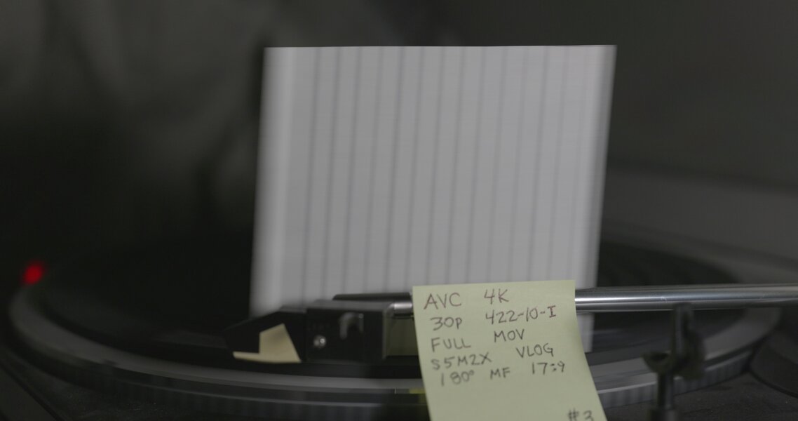

Attached are the first of two sets of frames grabbed from video. These are extremely boring images, so be sure to look at other folks' photos of pretty flowers, cool trucks, landscapes, etc. elsewhere on this forum to cure any brain damage possibly caused by viewing these test images. Z04 Flucht
The filenames of each image describe the S5iiX video mode used to record the original video clip. This first set is a "picket fence" simulation. A white card with vertical black stripes was attached to a phonograph turntable spinning at 33.3RPM (the turntable's slowest speed). If nothing else, the camera's rolling shutter is amply demonstrated by the way the moving card is tilted. But we all know the S5iiX has a rolling shutter, so no news there. In fact, there's no news here at all really.
Each video clip was imported into an empty Davinci Resolve Studio project with the same resolution & frame rate as the video clip. The only color correction done was applying the VLOG LUT, and doing a white balance using the eyedropper tool to click on the middle of the white card. Frames were exported out of Davinci as 16-bit TIFFs. They were converted to JPEG using Pixelmator Pro and saved at 80% quality.
Please excuse a couple of "typos" written on my paper labels. For example, ProRes clips are not "MOV", and HEVC 6K is 17:9 not 16:9. I was tired. :)

Nice test, but for me it is hard to see which one are the best. What do you think?
Checking the writing, the last ones look 'thicker', but these didn't have movement and might just be because you did more pressure on the pencil...
Stupid me, thats because of the different DOF

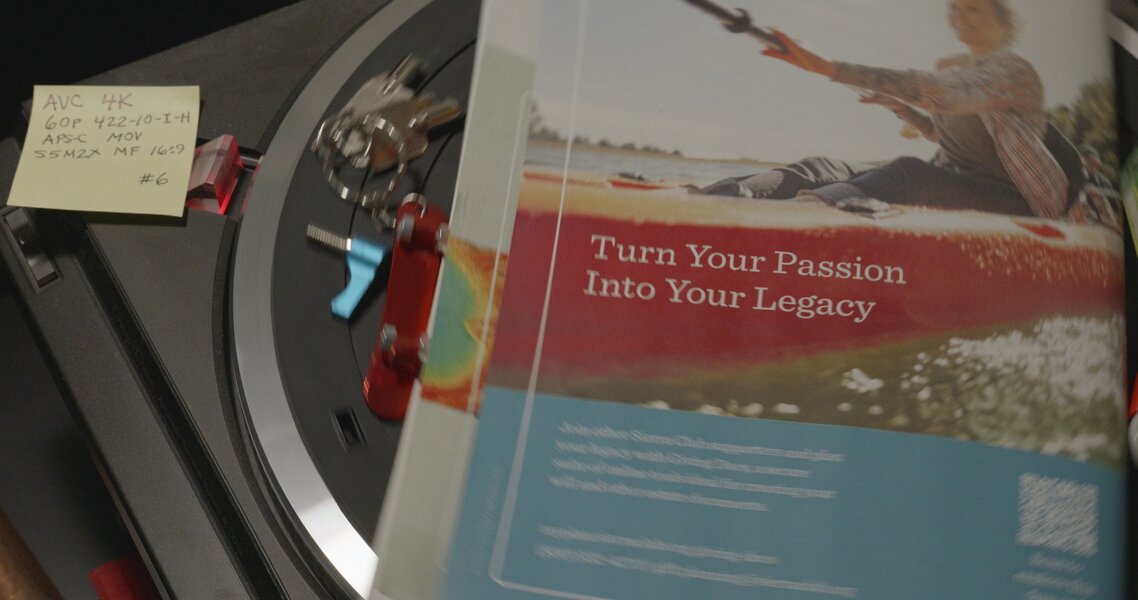

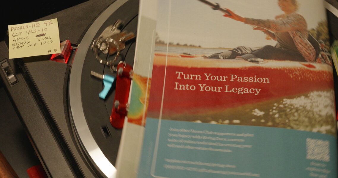

Here's my 2nd set of test images, this time featuring a more colorful target, and varying amounts of motion blur depending on where a detail is in relation to the center of the spinning turntable, frame rate, etc. Again, the filenames describe the original S5iiX video recording format for each image. I don't have any conclusions yet. As noted above, this isn't a perfect test, and doesn't tell us much we don't already know. Also as noted above, next I'll convert the ProRes HQ video clips to high-quality AVC (h264) and HEVC (h265) video and compare them to the original h264 & h265 video clips. I don't know yet if results will be useful. Cheers.
Good images, I'm a video guy.
But I am having trouble making sense of the images. The picket fence effect from LongGOP is a video effect, and I've not considered how it would show up with frame grabs. What might you expect? If you just play the video can you see any LongGOP effect? Or play the ProRes side by side with the HEVC, do they look the same?

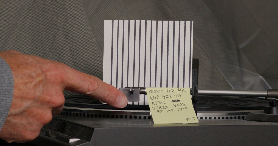

Here are the re-shot 4K 60p AVC & ProRes HQ clips in a new timeline. The lens is definitely focussed on the stripes on the white card. Note in the edit I swap back & forth between which clip is shown top/bottom.
One thing that really stands out with all the 60p clips (AVC & ProRes) are how the vertical stripes on the card are oddly "doubled". The actual card doesn't look like that (see the screen grab image below). The clips I shot in 30p don't have that effect; i.e. the stripes aren't doubled. I'm not sure what causes that. Any thoughts?
Strange. Just a thought, what is the light source? Is the motion blur maybe seeing the light cycle? I might try upping the shutter speed enough to get rid of the motion blur. Or make sure you have a flicker free light source.
(It is not a sin to shoot something other than a 180 degree shutter.) :cool:
Strange. Just a thought, what is the light source? Is the motion blur maybe seeing the light cycle? I might try upping the shutter speed enough to get rid of the motion blur. Or make sure you have a flicker free light source. (It is not a sin to shoot something other than a 180 degree shutter.) :cool:
Ah, I bet you're right: It's probably the lights. In each of the 6 times I recorded the 60p clips (3 AVC & 3 ProRes) I used a different light source. LED, then KinoFlo fluorescent, and lastly incandescent. Tomorrow I'll record 60p clips using natural daylight, to see if the doubled vertical lines go away. Thanks!
