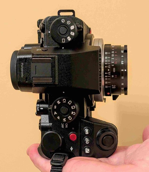

This is the Voigtlander 28mm f2,8 Color Skopar II VM on the S1RII. The adapter is the Light Lens Labs helicoid M to L adapter and gives M lenses a much closer manual focusing capability. I'm happy to see the sensor stack on the S1RII is capable of using this light weight and very compact lens. This makes a great package for every day carry.
