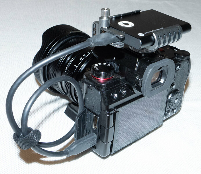

The good thing about SSDs is they are very cheap and fast and they hold lots of data. The bad thing is you need some way to mount them. Also it is not for sure you can run them for a long time before they might slow down. I tend to shoot shorter clips, a few minutes at most, so I've never seen problems with Samsung T5s or T7s. The Samsung T7 Shield is reportedly much better and would allow long clip recording with no issues. It is thicker than the T7 so mounting could be more of a challenge than the T7 which has been around quite a while. Here is a shot with a Samsung T5 held with a hot shoe SSD mount. I believe this is an old Kondor Blue mount, but several companies make this style mount, and it's about the best approach for a simple setup.
