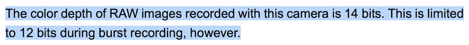

On p122 of the S5iiX user manual, it says, "The color depth of RAW images recorded with this camera is 14 bits. This is limited to 12 bits during burst recording, however."
