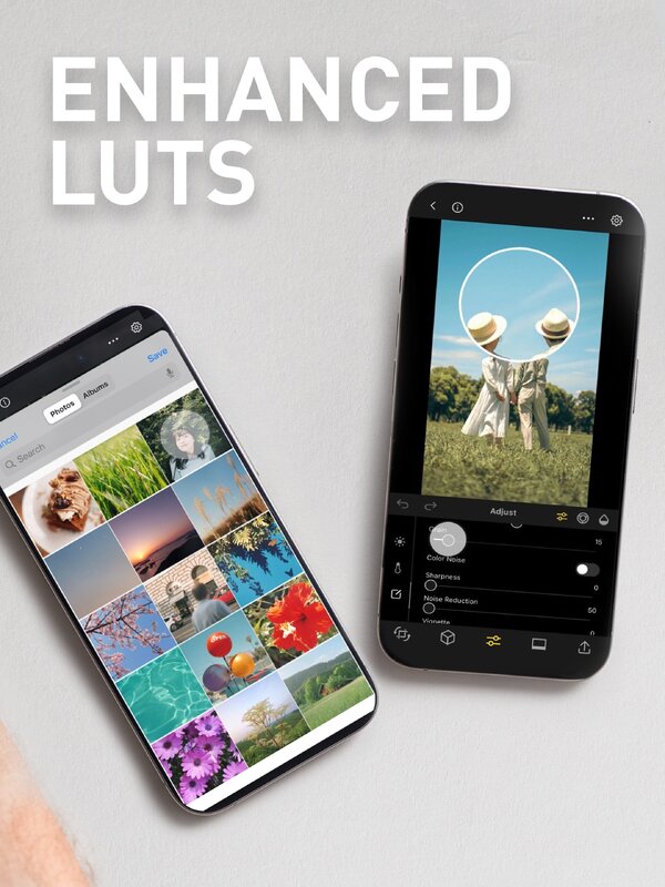

Enhanced LUT Parameters
LUTs now carry parameter tags for grain effect, color noise, sharpness, and noise reduction for richer, more nuanced looks.
