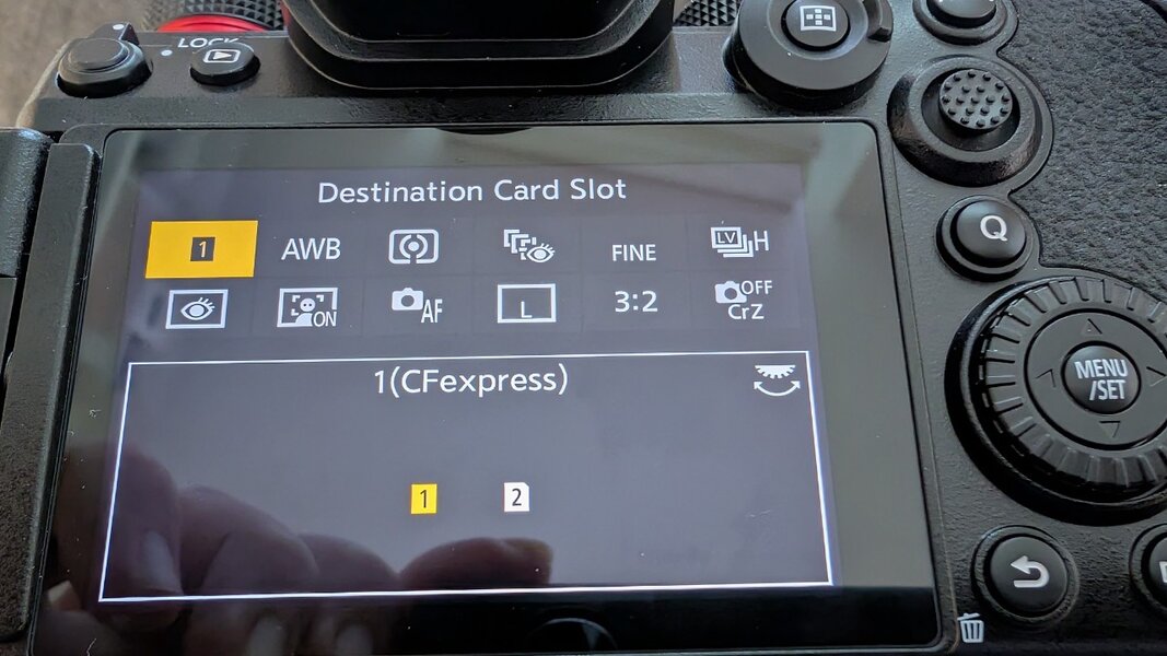

This is my current Q menu with all options for C1 for field hockey.
I changed one button already from hybrid zoom to crop zoom, but I do not know yet how it works. I do not see a difference between having it off or on..It does not zoom more.
Wasn't cropzoom for primes, with a on-screen zoomslider? I might be wrong...
It works for zoom lenses as well. Manually zoom to a a desired starting focal length, then crop zoom from there.
