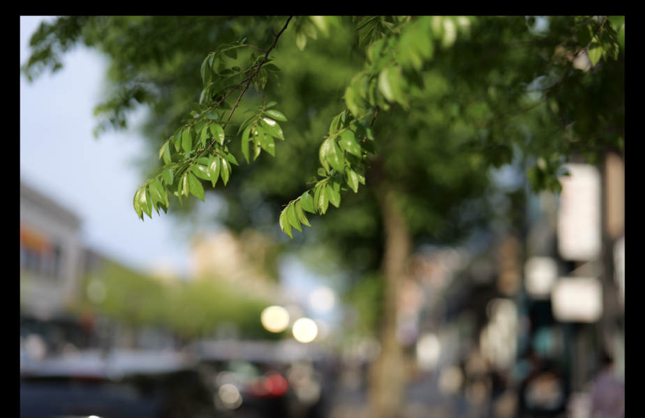

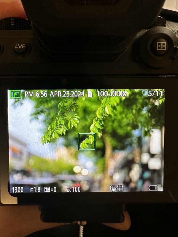

Hi, I just got my S5II and I updated the firmware today. However, I encountered focus issues. In the pictures I had 1-area focus (AFS) in the middle, however it seems that the camera focused on the left branches even though the camera showed a green box.
In addition, when moving from far to close focus, sometime the camera would fail to focus on the close subject but still show a green box regradless. I'll post some examples tomorrow if possible. Is there an issue with new firmware or is there something wrong with the camera? Thanks!

Probably cannot see very clearly in the screenshot (the original jpeg is too big). Maybe try the link here:
Not good. What lens are you using? Something funny is going on.

It seems that in AFC this issues still occasionally occurs. I've used 1-area focus and the result seems to be same. I've enabled quick AF and set the time to long as you've suggested and i try to film when the wind is calm. I think the small leaves in the beginning highlight the issue. (I've checked the it is farther than MFD - there are also some frames where it is in focus.) There are also weird scenarios where it does not focus far. In general it seems that the camera is "lazy" in focusing. Also I think 50mm 1.8 does not have a firmware update? The lumix website only have firmware for 50mm f/1.4.
I had a s5ii that worked well a while ago, but within one month of my purchase adorama had a huge edu discount on one of the kits so I replaced the original one with the new kit. So it has been back and forth and I was a little bit exhausted lol. Also I'll be traveling soon so I kinda want get it worked out asap.
It feels like if the situation is a bit complicated the camera just stayed on the focus before that scene, and only changes when it is very clear (there is no object in the foreground) (like when I focused on the bottom of the stem)
I've tested them indoors and it mostly works because it is nice and clear with no busy foreground and backgrounds. But I think at least the camera should be able to pick up the leaves shown in the beginning of the video?
