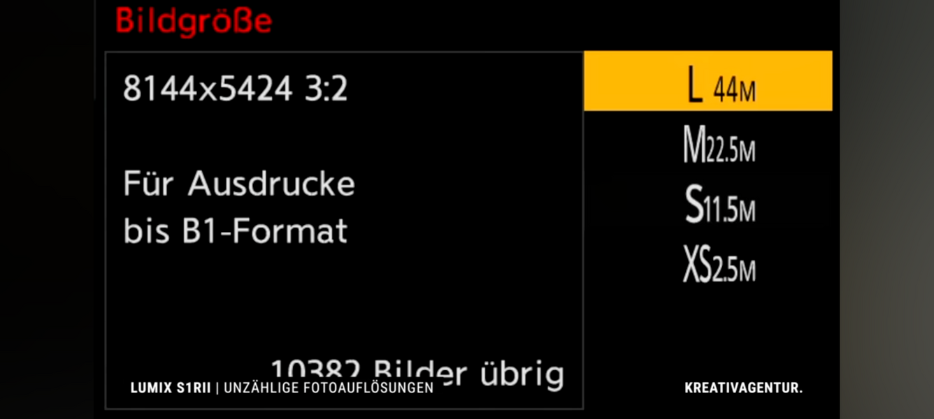

Hi,
I saw in a German review, that there is the possibility with the Lumix S1Rii to choose between different MP resolution.
How does this work? Is this for jpeg only or also for RAW files?
Is this the same way like with the Leica Q3? Full 24x36mm sensor size but less pixel by combining them like in a smartphone?
I saw this setting in no other review, but I watched too many anyway Z04 975
Maybe @Richard Wong can check this?
Pretty sure this is jpg only like previous Lumix cameras. But I can double check later and let you know
Yes please, thank you.
And ask them how it works and whether it works like with the Q3.
If it would be real pixel binning like in the Q3, this would be a game changer for me.
Yes indeed - mark me as interested as well. This could be very useful for astro.
Just checked. it's for JPG only.

I haven't test the Q3/SL3's small RAW, but when I previously tested the small RAW output from Nikon cameras, I saw no difference in terms of image quality compared to resizing a full size raw ourselves in Photoshop.
The only way I can think of that would give us better DR would be if the sensor has a different readout mode that exposes some pixels shorter than the normal pixels.
Some quad Bayer sensor allows that, for example the Kandao QooCam3 Ultra has a special mode that increases dynamic range (preserve more highlight) by doing exactly that when you choose the lower resolution output. However since some pixels are now exposing at shorter interval, the trade-off is that lowlight performance is worse than the normal mode.
Still it is a pretty fascinating trick.
Does the Leica Q3/SL3 sensor have this kind of trick?
If not, the smaller RAW should be just summing/averaging the value from 4 or more pixels into one. So mathematically, it should be the same as doing downsizing in Photoshop as long as you choose the correct re-sampling algorithm.
That's my understanding at least but I would love to learn more if anyone know more about it :D
Thank you. Only jpeg. That is a bummer.

Binning was „invented“ with astrophotography in the 90s to raise sensitivy. I did my diploma at physics at that time with photometry of stars using first commercial CCD cameras from that time (ST6, ST7 if someones remembering these…).
Every pixel is like a barrel collecting photons and with binning during the read out all the collected photons where put together in a bigger 2x2 or 3x3 barrel (to keep it simple). With this trick the sensitivity could be raised and also the signal to noise ratio was better.
BUT: these cameras where all monochrome! With todays bayer sensors and using a real 2x2 binning you would mix 2green, 1red and 1blue pixel from the matrix. Could be also possible but requires a totally different processing! These 4 pixels would create a real RGB pixel by loosing resolution and creating high demand on memory for this pixel. I think thats the reason why nobody think about it.
But Canon offers some years mRAWs with reduced resultion, but I habe no idea how these are created.

Thanks everyone for the replies. @RBecker that is - I think - exactly what the SL3 does. Again "mathphotographer" on YT does a deepdive on the SL3 binning feature and does show that the 33 MP raw file has 1 stop more DR than the 60 MP raw file. If you ever have the time to watch it, I'd be curious if you think his methodology is good.
And @Richard Wong yes, Leica does seem to have this trick.

Thanks everyone for the replies. @RBecker that is - I think - exactly what the SL3 does. Again "mathphotographer" on YT does a deepdive on the SL3 binning feature and does show that the 33 MP raw file has 1 stop more DR than the 60 MP raw file. If you ever have the time to watch it, I'd be curious if you think his methodology is good..
I havn‘t look the video yet, but I will do!
In general: If you reduce the resolution from 61MP to 33MP by interpolation you will reduce noise and by reducing noise you gain DR. The same happens if you stack multiple pictures like doing with HighRes mode or in Post. That is why I use HighRes with my OM1 and the S1R already some time (if possible), because the RAWs are much better for editing in post. It is a real push for city nightscapes or architecture, especially for the smaller MFT sensor!
It would be interesting to get info from a programmer who works and decodes raw files. There are free raw tools and Leica uses DNG, so the logic should be freely documented. I raw just from smaller resolution alone seems not simple…
