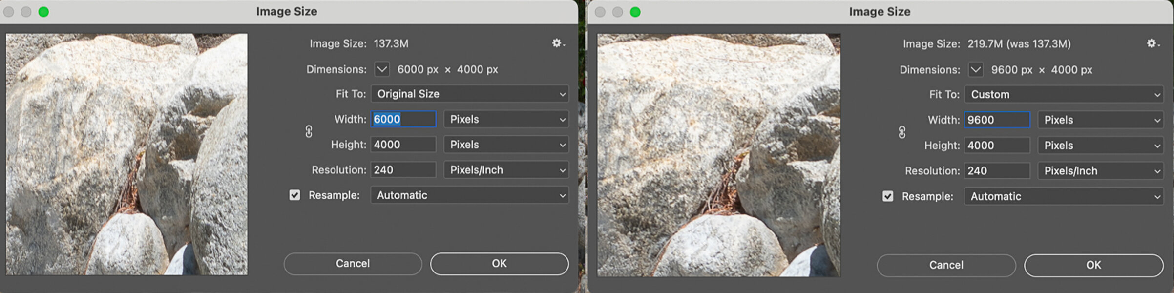

In Photoshop select Image < Image Size. This shows the Image Size screen. Here change the image width by 1.6x. Change pixels from 6000 to 9600. This de-squeezes the image.
