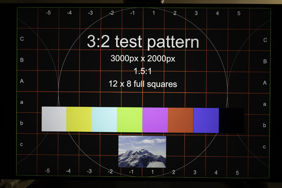

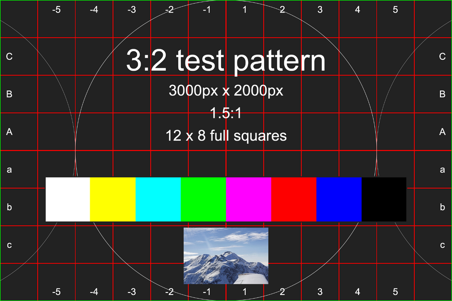

For my own understanding I set up a test to see what rectilinear looks like at 18 mm with this lens. I used VIOSO to design a 3:2 test pattern with 96 equal squares in 12 columns and 8 rows. I displayed the test pattern full screen on my monitor, and set up the S1R II on a tripod to photograph the test pattern. I aligned the camera to be centered and the correct distance and perpendicular to the test pattern as best as I could without the aid of a precision alignment setup.
This is the test pattern
This is the JPEG photo in Lightroom
Note the test pattern is not perfectly aligned, but is pretty good. This photo has a small amount of barrel distortion, probably not enough to show in most photos. I printed this out and measured the squares in the middle and at the extremes. Within the limits of this test they are all the sme size. Circles, faces, people would not be distorted under these conditions.
