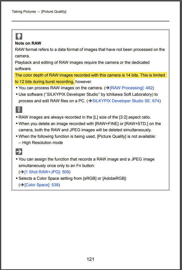

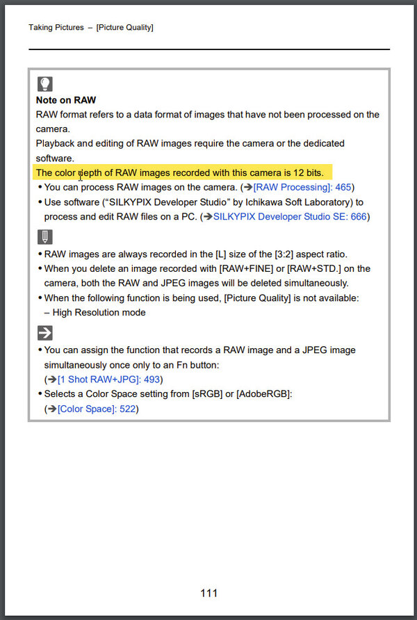

The S5II manual page 121 (see below) states that RAW images are recorded in 14-bit except during burst recording where the camera drops to 12-bit. It does not say that this has anything to do with electronic vs mechanical shutter. My understanding is that the drop in bit depth on the S5II was done to attain higher FPS recording rates than the original S5.
The S5 has no such constraints and records in 14-bit depth.
The S9 by default records in 12 bit depth (see manual page 111 below) and I assume this was done to retain the 30 FPS burst speed. I don't think it has anything to do with the lack of mechanical shutter given that the S5II has no such limitation. I think the DPR reviewers have made an assumption about the S9 because some other brands (notably Canon) drop bit depth with their electronic shutter. Panasonic has never said this is the case.
As Oíche mentioned above, there have been some posts about bit-depth of the S5II in the forums here and at DPR too.
View attachment 7901 View attachment 7902

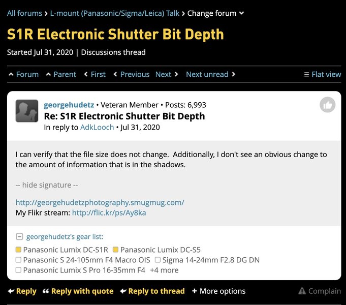

I just did a Google search and found this, by a certain @GeorgeHudetz :
