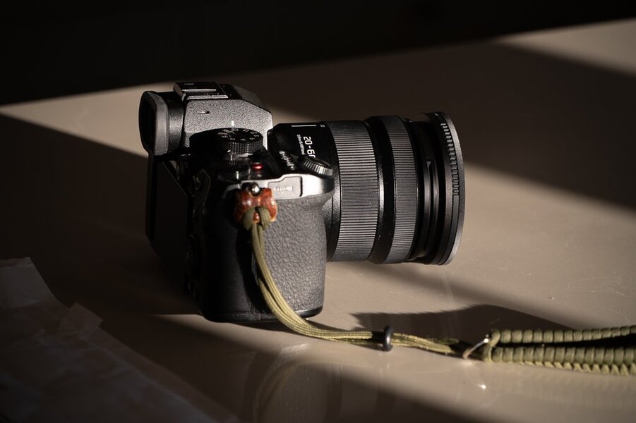

1) Initial impressions & apparent build quality
The lens feels very nice in the hand. It's the usual Sigma Contemporary TSC plastic but the finish is very nice and it feels very solid. It's weather sealed and it feels like it'll last (says the man whose 70-200 f4 has just died and that's a lens that feels great too!!). I think this shows that apparent build quality is very subjective and probably doesn't correlate with reliability at all. But having said all that, I really have no complaints about the 20-200, especially at the price.

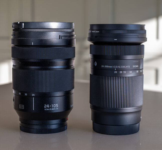

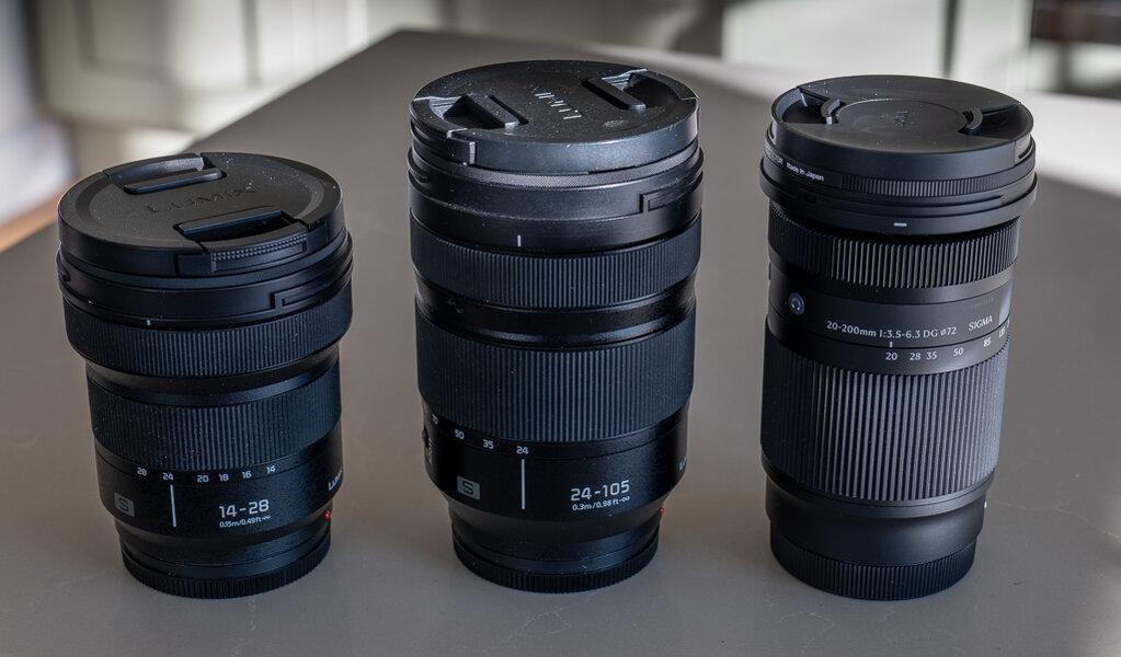

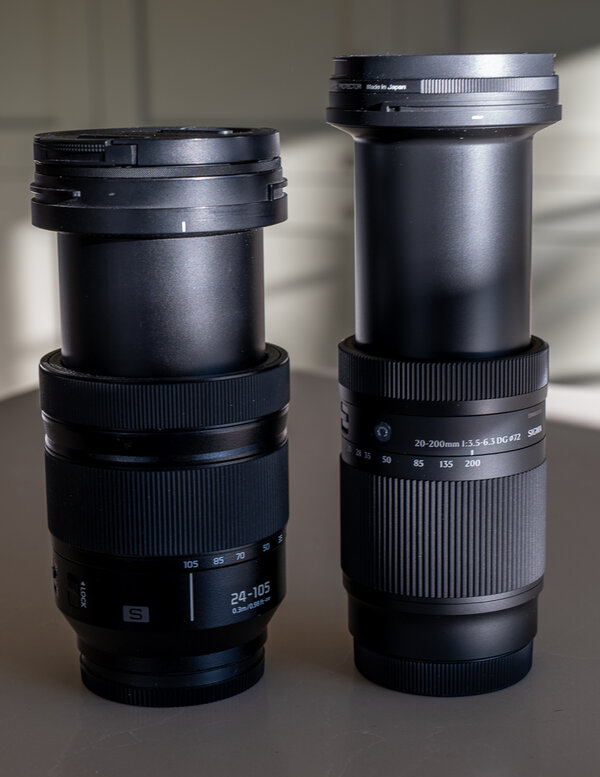

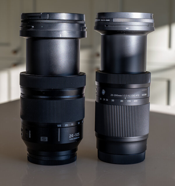

Overall the lens handles pretty well. It's not too heavy and is fairly compact when collapsed. I've posted some comparison shots against the 14-28 and 24-105 below. You'll see that it's basically the same length as the 24-105 when both are zoomed out and also when zoomed to 105mm. At 200mm, the 20-200 is longer than the 24-105. It's lighter than the 24-105, but of course, it has no OIS and it's not a constant f4.
The zoom ring operates backward compared to Lumix lenses, which is a bit of a pain but it's not a deal breaker for me. The zoom operation is pretty smooth and has no creep, but it has to be said that the required movement of the zoom ring to go from 20mm to 35mm is very small, and 20-24mm is maybe 2-3mm of linear movement. This results in small adjustments to focal length near the widest setting being quite jerky. Again, not a deal-breaker, but I'd have liked a larger zoom throw at the wide end.
Other than that there is not a lot to say about the handling. There's an AF/MF switch and a lock slider (but there's no creep at the moment so I don't think the latter is really essential).

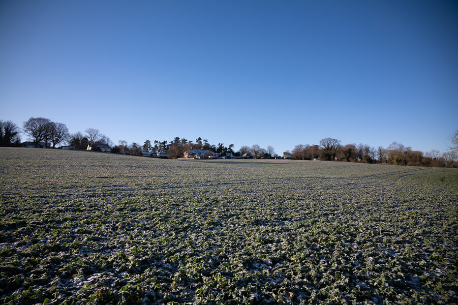

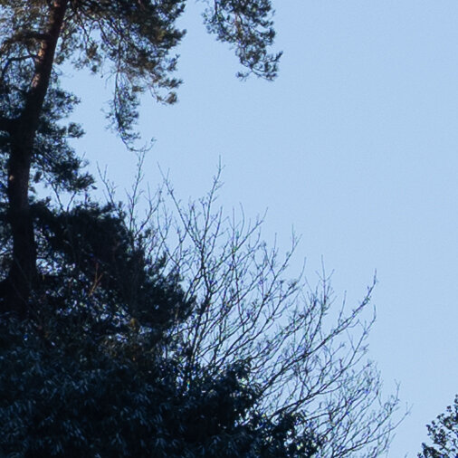

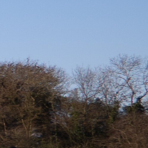

i) 20mm - comparison at apertures of f3.5 and f8.
The overall scene:
f3.5 - left, centre, right
f8 - left, centre, right

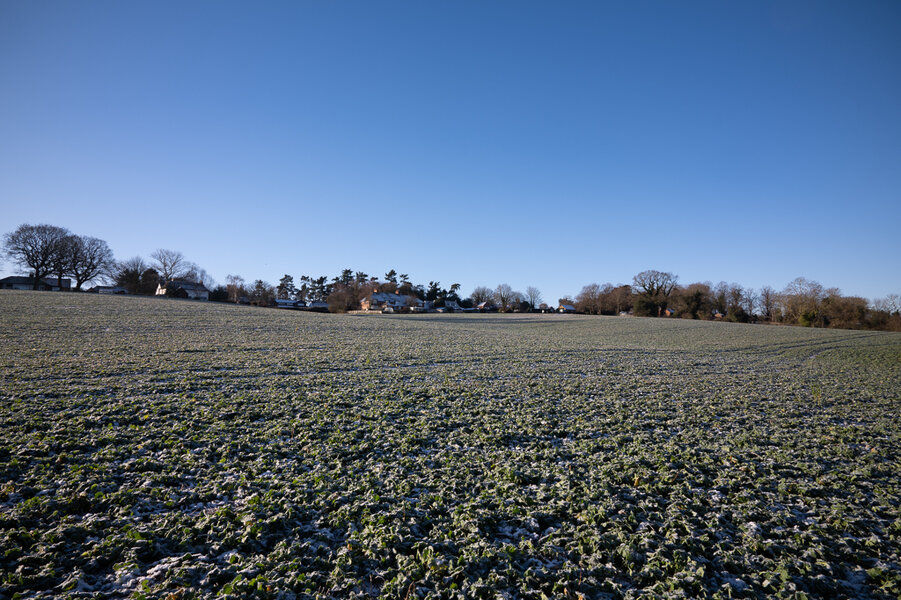

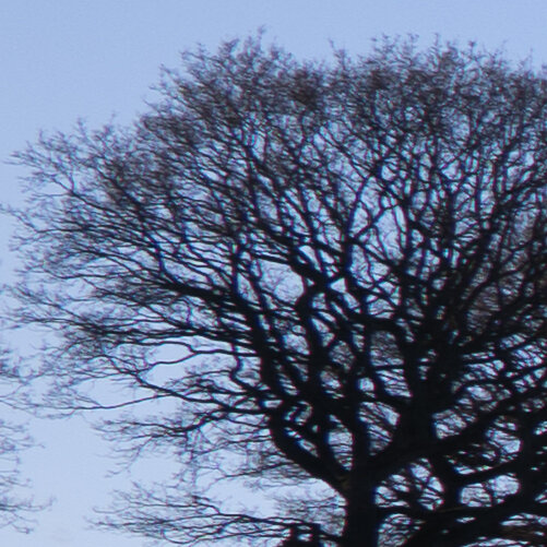

ii) Comparison with 14-28 at 20mm and 28mm
You can click on the images in the grids to get a larger version.
20mm
LeftCentreRight
20-200
14-28
You can see here that the 14-28 is a little sharper at the edges. It's not a lot, but it's there and quite clear in A/B comparisons at full zoom on the PC.
28mm
LeftCentreRight
20-200
14-28
Here the 20-200 is slightly better than the 14-28. This doesn't surprise me since the 14-28 is at its weakest at the long end.

It extends a lot at 200mm

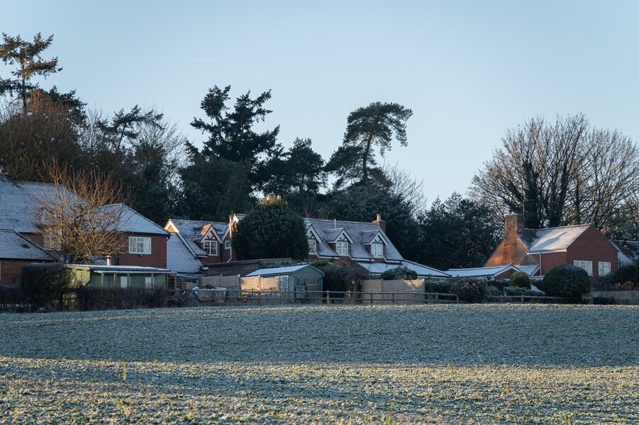

vii) Overall image quality
I realise that I've focused (no pun) on things like sharpness, flare etc. But I think it's worth adding a few words about the "global" image quality - that is, how photos from the lens "look". The examples above probably show this, but I think it's worth mentioning that images from the 20-200 have really good levels of colour, contrast, and vibrancy. To be honest, this was an area I found really lacking in the 28-200 with images loosing a lot of contrast towards the long end. There is none of this with the 20-200. Here are a few examples at various focal lengths to illustrate the point (none are "proper" photographs, just snaps of things around the house and garden.
