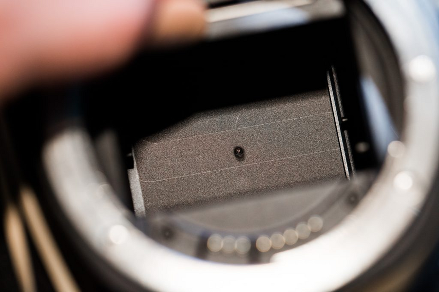

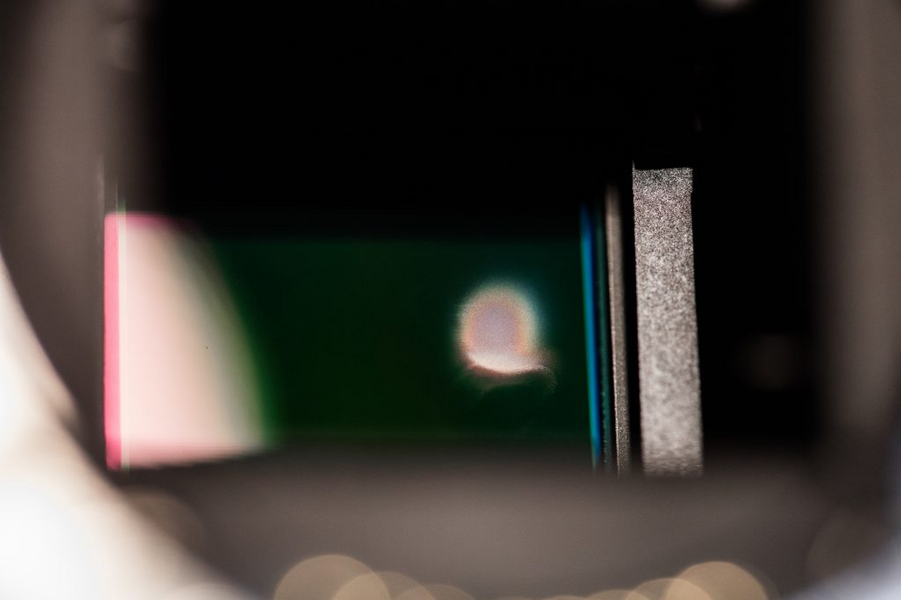

That's a very interesting article. It confirms to me that both the shutter and sensor are susceptible to damage if you focus the sun on their surface. I've posted some examples below.
Bottom line for me is that you should avoid getting the sun to shine directly into your camera if it's motionless (e.g. on a tripod or resting on a flat surface); irrespective of whether you configure the camera to close the shutter or not at powerdown. Always put the lens cap on!

Interesting. When I read the warnings, I thought Panasonic was warning us about the potential damage that could occur if you remove the lens and just let the body sit there for a while with the lens removed and no body cap on. After all, the shutter is closed, correct? So letting it just sit there for a few minutes with the shutter exposed (but not the sensor) is perhaps not a big deal, right? Not that I agree with that, but I could see people making that assumption. And, if they were to do that while the black shutter is exposed to direct sunlight on a hot day, I could see it permanently warping due to the resulting thermal stresses. Shutter gets hot, warps, and you are done.
Anyway, certainly the LensRentals article shows that if this happens with the lens on - i.e., you point the lens directly at the sun with no lens cap for too long, you are likely to burn through the shutter AND the sensor. So it really doesn't matter if the shutter is closed or not.
