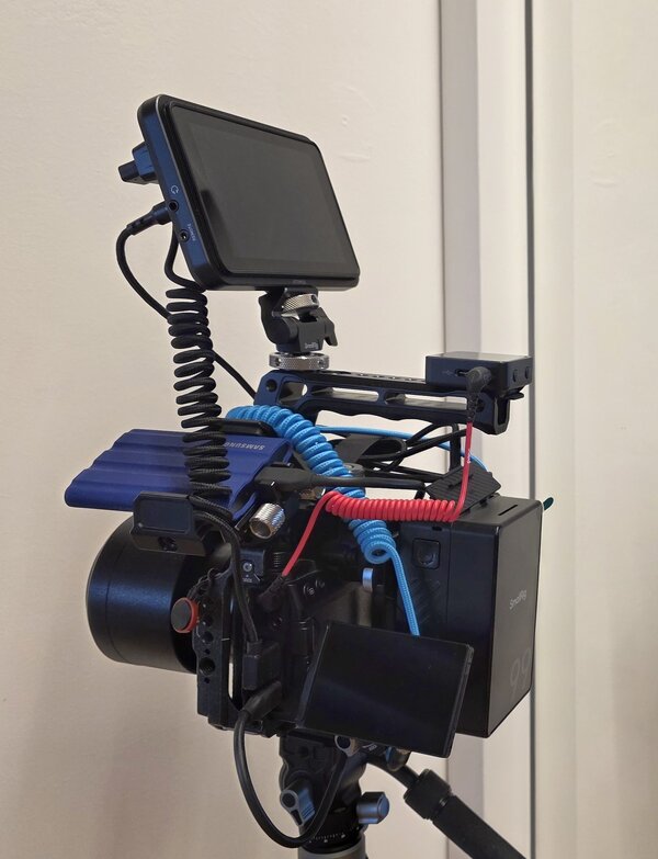

I have to conduct a series of interviews; this is my interview rig:
Camera A:
-Lumix S5 ii x
-Lumix 85mm f1.8
This camera will focus on the main person of the interview.
Extra gear:
SmallRig cage blackmamba
SmallRig V Mount Battery VB99.
SmallRig V Mount Battery Plate.
Kondor Blue Dummy Battery with D-Tap cable
Atomos Shinobi ii, 5" Camera Monitor
Rode wireless pro microphone
SmallRig Top Handle
Samsung SSD T7 Shield 2TB
SmallRig SSD Holder
Manfrotto befree tripod
SmallRig Video Head Mount with Arca Swiss Plate
The VB99 battery will be used for the camera using the Kondor Blue Dummy Battery connected with the D-Tap input and will be used for the Atomos Shinobi ii monitor with a USB-C cable.
Camera B:
-Lumix S1Rii
-Lumix 24mm f/1.8
This camera is designed for a wide, more contextual shot. That's why I'm going to use a lens with a wider angle of view.
Extra gear:
SmallRig cage
Neewer DMW-BLK22 Dummy Battery
SmallRig NP-F Battery
SmallRig NP-F Battery Adapter Plate
Lexar Professional Go SSD
Rode Shotgun microphone
Manfrotto tripod
Unfortunately the Lumix S5iix does not have Bluetooth support for Timecode, so the Atomos UltraSync BLUE can not be used to synchronize the image from the two cameras (another reason to get the Lumix S1iie). I want to use the Time Code of the Rode Wireless Pro, but I'll have to do the waveform synchronization with DaVinci Resolve Studio:
On the S5IIX the Rode's Timecode (LTC Audio) will allow to automatically sync high-quality audio from the transmitters to the video. The S1Rii will record the reference audio with the internal microphone. In editing the idea is to sync the Rode's internal audio with the S5IIX video using the Timecode. And after that to align the S1RII video using the Waveform against the already synced audio from the first camera.

Hi Charles, I bought this SmallRig Video Head Mount Plate with Leveling Base CH20-4170 with an Arca-Swiss plate because it can be used with the SmallRig cage for the S5II and S1Rii. To be honest, it's not the best video head mount in terms of vertical and horizontal movement, but for interviews where the camera is fixed, it was a fairly inexpensive (€68) and compact solution.
I bought this SmallRig Video Head Mount Plate with Leveling Base CH20-4170 with an Arca-Swiss plate ...
I tried that and another one or two. I agree this can work if the camera is fixed.
